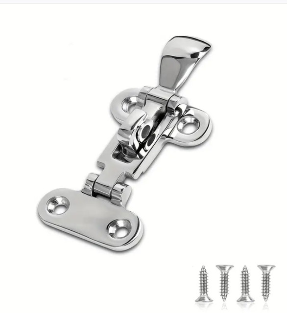

For people looking for chrome catches and wanting to buy new, while researching I also found these options:
OPTION 1:
The above are available from Vintage Supplies at £55.00 a set plus postage.
https://www.vintagecarparts.co.uk/products/303-over-centre-catch-2
OPTION 2:
For the same money the following are available from Woolies the trim people:
https://www.woolies-trim.co.uk/p-1132-small-over-centre-catch
OPTION 3:
And finally for those on a tighter budget you can find these Chinese made catches all over Ebay & Temo etc for around £15 a pair.
In the end I decided for the same money as options 1 & 2 a set of the very sturdy Triumph hood catches would look best, and be strong enough to deal with the hood tension too.
