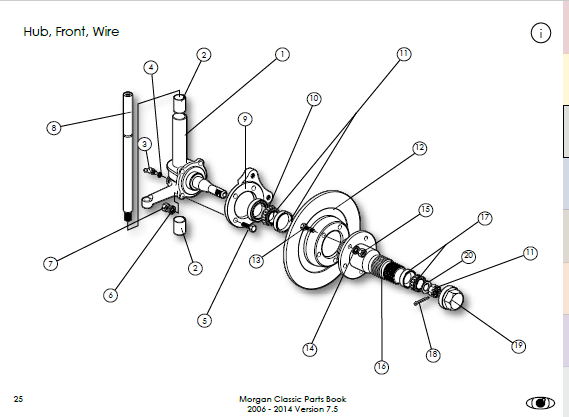

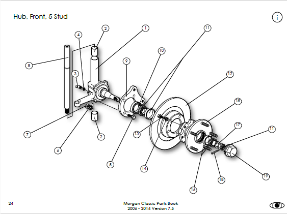

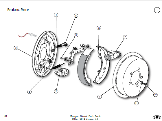

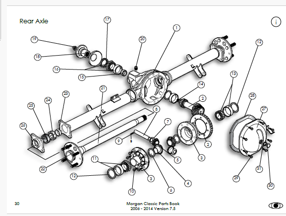

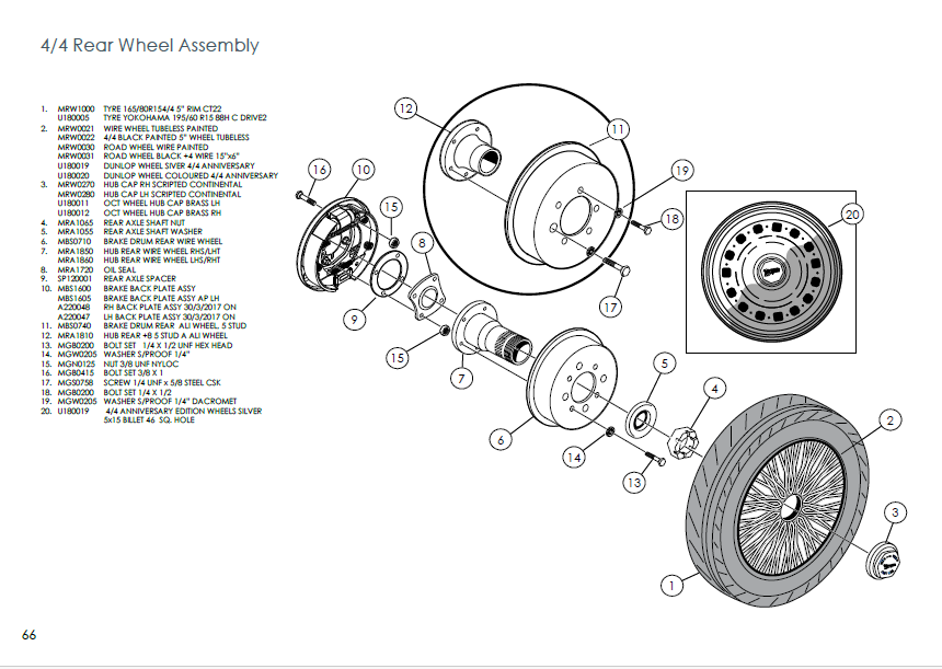

On the later trads just a new hub and brake drum are listed to allow fitment of 5 stud alloy wheels. Not sure if there are options for the axle on a 1965 car.
And here are extracts from the parts book for 2006 on. The last picture is from the 2014 on book. They are all for trads

Thanks John. It was on the basis of 2014 on book I suggested just hub and brake drum differed, when alternate half shafts are needed as well. Completely forgot about front blush
It's a little known fact that the 5 stud front has hubs with approx 8.5mm less offset requiring different caliper mount plates as well and leaving the car with 17mm narrower track. No big deal as front track is significantly narrower than rear anyway. Discovered all this when rebuilding front earlier this year.
