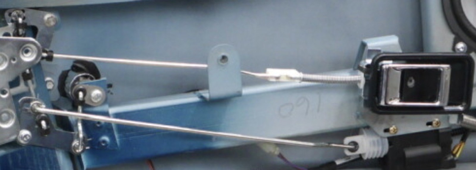

John V6. Very helpful photos John. I am attempting to upgrade the front speakers in my 2020 Plus Four, and have spent a frustrating morning trying to remove the door cards to arrive at the same point as you in the photos above. No real problem in removing the bottom section of the door card which comes free after removing the visible screws, the door pull and freeing the door catch. However the mid section of door trim is proving much more difficult. I am assuming from your photos that it is clipped into the wooden top frame ( I can see the holes in your photos), but I have found it difficult to extricate whatever plug/clip from the retaining holes. I don't want to break anything, yet I have exerted considerable force both pulling and leverage with a trim tool to no avail. Perhaps I being a bit too cautious - what is your experience? Do the clips suddenly yield? Are they prone to break? Is there a tool? Am I missing something? Any help would be appreciated.

There are tools you can buy or you can use brute strength. I think I used a screwdriver with card behind to protect the leather near the fixing plus pulling the card.. The one right at the front can be left as you can just get access.
In typical MMC fashion the passenger side was a pig, the drivers side easy

Had to remove the door card last week - the handle failed on the way to an MOT. Told it was a failure point not being able to open the door from the inside.
The metal rod from the door handle had disconnected from the small plastic block.
