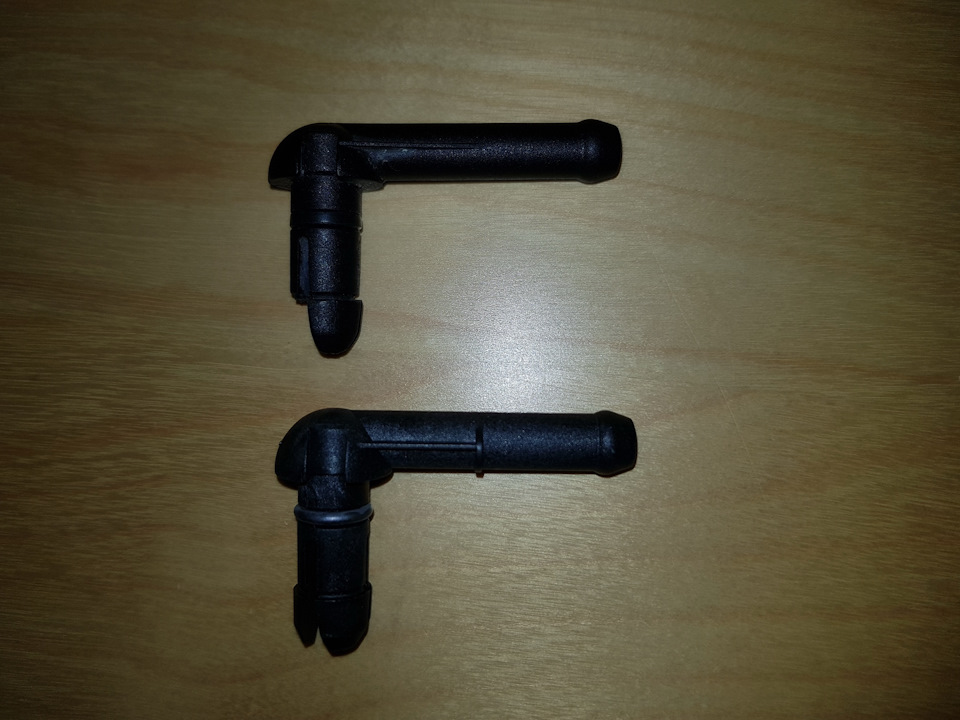

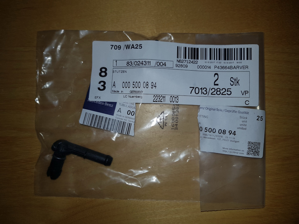

I read this thread because I also had a coolant drip, but it was under the left hand side of the radiator.
There is a small weak point in the radiator design in that an 'O' ring in a the mounting of a small spiggot on the top of the radiator can start to leak. I suspect quite a few owners have replaced their radiators because they could not find a small spare part or the source of the leak-
Mattmog put me on to the solution, and then I found a reference which gave us the part number on, of al places, a Ukrainian forum.
Here is the photo of the part, showing the part number, that Mattmog purchased.
I carry a spare in the Morgan just in case I get a failure on a trip.
I mention it here because, although the source of the leak is different, someone might find this thread while searching for a solution.

Good find Peter, looks like it's made in Germany (I wonder if the OE rads are too ?)
Posts: 14,748
Posts: 14,748
Sorry I should have mentioned that the original part number was for Mercedes-Benz.
I would imagine that Morgan sourced a radiator that was used in some Mercedes-Benz or BMW model rather than having a custom radiator built.
I sourced my spare from a Mercedes dealer but the Ukrainian forum was for BMW owners. The Ukrainian gave the Mercedes part number but it was for his BMW. He could not find an equivalent BMW part.
In reality it is only the 'O' ring that needs replacing but it is almost impossible to remove the spiggot without breaking it. The plasticis probably somewhat "cooked" after several years in boiling temperature water.

I have noticed some fogging of the antifreeze on the top of the radiator, where the air bleed hose comes to the return connector. Was observed only when cold. Seems like the o-ring has dried out and is leaking slightly when the car is cold.
Trying to gently pull it out to replace the ring I eventually broke one of the three anchors, and then I got a surprise. BMW is like that, it doesn't come as an individual part, you have to buy the radiator assembly...
Good thing other manufacturers are smarter, and I found some info on the internet that this part is perfect for a Mercedes. I decided to use it because it can be delivered the next day.
Part pictured: A0005000894. BMW 7 series (E38)
Parts pictured: A0005000894
Mercedes A 000 500 08 94
Hella 8MY 376 743-321
BMW 7 series (E38)
You can clearly see how the O-ring is shrunken
Price: 4 € Mileage: 393,000 km
Plastic outlet.
