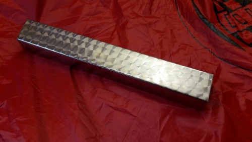

Or try a bit of DiY ? ![[Linked Image]](https://tm-img.com/images/2019/01/18/Crossmember-covers-1.md.jpg) ![[Linked Image]](https://tm-img.com/images/2019/01/18/Crossmember-covers-2.md.jpg)
