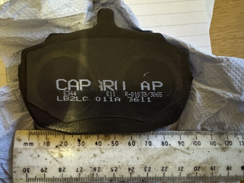

Taken out one pad, still has 8mm wear on it and 4mm to bottom of groove so loads of life yet.
I'd still like to replace them but no idea what with - every link I follow looks different and most look different to these

yep I've been poking around for some time and found this from Montegue about 6 months ago
"As per this thread and others on TM, the pad code for the Caparo calipers used on my 2012 registered Duratec Plus 4 is MLB52, so I went looking for a set of Mintex MLB52 pads in the M1144 fast road compound and discovered while I can still buy new/old stock Mintex actually discontinued M1144 at the end of last year. However, for Jan 2024 Mintex replaced M1144 with their new fast road compounds MRM1801 and MRM1802, here's what Mintex say about this change"
that's pretty much where I started but MLB52 isn't available any more according to Mintex and if they were then the replacement compound M1144 isn't certified for use in my application!
however Ive found these (but I'm not a big EBC fan)
