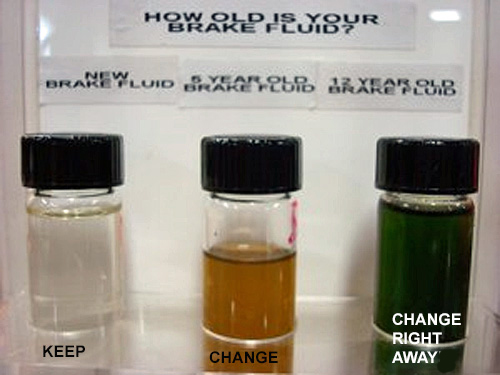

DOT 5 was developed for the US military. They wanted a fluid for their lighter vehicles that could better withstand extremes in temperature than the then available standard fluids DOT 3 & 4. Since then they have been trying to get Congress to allow them to switch back to a regular glycol-based brake fluid. However, safely swapping a brake system from silicone fluid to glycol base or vice versa is tedious, costly and dangerous. No automobile manufacturer delivers their cars with DOT5. Unfortunately, the USA Department of Transport US created a lot of confusion with the name. DOT5 is totally non-compatible with any other brake fluid I can recall. When combined with even trace amounts of a glycol brake fluid it can create, unknown to the user, a goo-like residue which can cause partial or complete brake failure. NO automobile manufacturer delivers their new vehicles with DOT5. Far too dangerous.
DISADVANTAGES of DOT5
a. DOT5 is not compatible with any other brake fluid or water. That fact can be very sad when combined with another more common type of fluid and most especially when the perpetrator is not aware. When combined with even trace amounts of other fluids, it forms a dangerous goo which prejudices braking, at times quite sadly. One must very carefully to flush the system if swapping from any other type of fluid with DOT5 or back. Other posts here note that.
b. One must accept that water will ALWAYS enter your brake system (regardless of what fluid you use) to a degree dictated by your environment. However, DOT5 is also incompatible with water. So the water that has entered the braking system "puddles" rather than combining with glycol brake fluid which will cause that fluid it to deteriorate but still not attack your brake system. These DOT5 water puddles internally attack brake components in the form of internal rust. However, like so much automobile wear, the effect is both invisible and so incremental that a normal driver doesn't notice. frown It can only be ascertained at a brake fluid change which the look of DOT5 discourages.

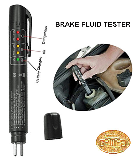

c. Of course, due to the factors above, DOT5 is immune to a quick brake fluid tester. If uselessly tested, they give a false, happy reading as the testers are deigned to determine brake fluids water content, which with DOT5 is always 0. DOT5 will also not change colours as glycol fluids do. So there is NO visIble evidence either of the water DOT5 is hiding. This even fools mechanics who only see crystal clear DOT5, regardless of much water is in the system, This even fools practised mechanics. I prefer the ease and certainty of testing. Testers are cheap and it only takes a second.
BTW,aside from becoming more vulnerable to heat and the rusting thing, water can be used as a brake fluid when in a pinch.Just get rid of it as soon as you can.
d. DOT 5 brake fluid becomes frothy when pressed on and off repeatedly. It results in the same effect (shiver) as ABS brakes.
e. DOT5 should be changed at least as often as any brake/clutch fluid, especially in the UK, where we kept a second Morgan for a wonderful decade. . Whether your car is used or not used, water enters the braking system. The safe brake/clutch interval change recommended by manufacturers is once every two years at least.

If you want a better brake fluid, capable of handling higher heat (from exhaust or a potent engine) better than DOT3, DOT4 or DOT5 can move to DOT 5.1. DOT5.1, unlike DOT5, is an upgraded glycol fluid completely compatible with the first two (but not of course with DOT5.) Yes It is harder to find and a few quid more expensive but the compatibility means it will not cause any of the sadness noted above if you have to top up DOT3 or DOT4 roadside OR the other way around.
BTW, lately some upper class cars, like Volvos and Jaguar use DOT 5.1, along with ISO 4925 Class 6, in their newest vehicles. Ford also utilizes DOT5.1 in its performance cars. They call it Ford Genuine Fluid PM-21 DOT-5.1. DOT5.1 fluids also often contain rust inhibitors to prevent the corrosion of metallic brake components and to reduce oxidation at increased temperatures. It has a lower viscosity (aka thicker) than DOT 3 and 4, so it theoretically improves braking performance, especially in extreme conditions. However, I have have been using DOT5.1 for so long in all my Morgans my brake leg cannot remember the difference. Sorry.
