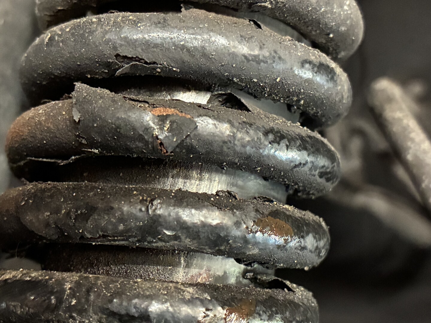

Those who think streuth what a state. It looks much better now I have cleaned it up. My car is used virtually every day & lives by the sea.

Thank you IcePack. With two fresh greasings under its belt the graunching has reduced considerably, but I will have a look to see if there are abrasion marks behind the springs (also live by the sea and also use almost daily, though I suspect there's less salt in the air in southern Sweden than in your fine town)
