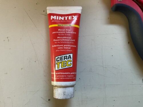

I have an awful rattle up front, when I gently apply the brakes it goes.
I can only assume it’s the pads rattling. They don’t appear that loose in the calliper.
Anyone help with this one?

This may be worth trying, if not already used.
I have , on my Plus 4, an additional “shim/ anti rattle plate” , I put a smear on all the non friction surfaces.
It might help on your car.

Sorry, on a more sensible issue above, pop out and clean up all the pads and as Bishmog recommends, use some CeraTec as it's safe with ABS equipped cars

Thanks Chaps.
I’ve taken them out and cleaned them.
I wonder if that Cera tec would work like Copperslip?

Coppaslip is very old tech and if you have ABS sometimes has issues because it's conductive, I swopped to CeraTec several years ago

It’s ok. Having just taken a wheel off again it suddenly dawned on me that it’s the floating discs rattling
