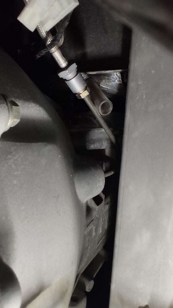

My Roadster has concentric clutch slave but to my knowledge no external bleed nipple. Here is image loooking back down left hand side of engine towards bulkhead.
You can see coupling of flex pipe from clutch master cylinder to short solid pipe which disappears into bell housing. Not very accessible anyway. So far have just sucked out fluid from reservoir and replaced.

Richard, typically on a concentric slave cylinder system the bleed nipple will be found on the end of a length of flexi hose (possibly braided), a remote bleed nipple if you like, its likely tucked to be away so may be somewhat hidden at first glace.

Richard. I have the Ford MT-75 gearbox and my flexi feed pipe from the master cylinder and bleed nipple sit at the rear of the bell housing on the top just below the fire wall so easy to access. It's a modified Ford slave and they? Morgan have fitted a bleed tube to run inparrallel with the hydraulic line so they sit together at the top of the bell housing. Most later cars have a different bleed system altogether when a concentric slave is used. this is often directly associated with the main line into the bell housing, might be under a rubber blanking cover at that point or may be even on the other side of the car from that entrance point of the main feed line. It mainly just looks like a stubby plastic pipe and will have a small metal wire clip across the pipe. This may need to be fully removed or pulled back to a stop position where it remains in place. You can then pull the end of the pipe outwards just one position, about 1/4" and that opens the bleed tube.
I think you have the Ford MT-82 transmission as fitted to the Land Rover Tdci engines. As you also have a Ford engine I can't see that it wouldn't be standard but then again! I have the technical paperwork from my LR days so I'll see what I can find out for you. Often both feed and bleed are under a cover that needs popping of for access.
I have to say, That although mine is accessible I tend to keep an eye on the colour of the fluid and suck it out as you describe as in my case unscrewing the bleed nopple just might fracture the bleed pipe within the G/box Then it's an engine and G/box out job!

Thanks for replies but I haven't found any signs of clutch bleed nipple on 3.7 Roadster and neither has anyone else to my knowledge, although would be pleased to be proved wrong. No hint of it in parts manual either. Will have a closer look when next have it on the ramp.

No need Richard. I think your roadster has the 2009-25 Mustang set up. Your'e right there is no bleed facility. You can check as it will have a separate reservoir ie. not a combined brake master cylinder. If fitting a new slave cylinder.... perish the thought! You would need to bench bleed the slave prior to fitting in the bell housing The only bleed option you have is to remove as much fluid from the reservoir as you can and fill with clean fluid then pumping the clutch pedal several times until on obsevation no air is exiting the reservoir which will show as bubbles coming through the brake fluid. Adjust to correct level and that's it. If you repeat this process a couple of times it will have some flushing effect if fluid is dirty.
Designed for the mustang it is believed the clutch components would need replacement prior to slave failure and should be changed when clutch is changed although it does say about using the slave again on clutch service..... perhaps that is for an early clutch failure scenario. Hope that helps with the head scratching.Oh! nearly forgot, The slave unlike the master cylinder will not produce the dirt that the master will as its a bellows system with no internal friction.
