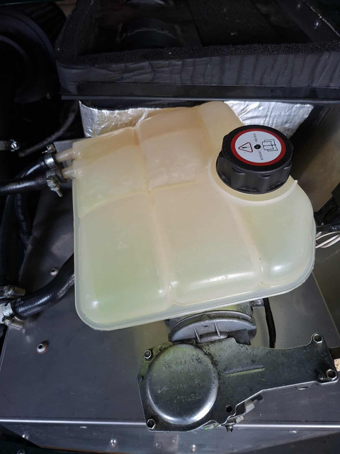

Had a closer look at my tank today and the vertical surfaces are very clean; BUT, I now see that the horizontal section that is at about the same height as the MAX level, has a thin layer of brown sludge. I would not have noticed unless I looked up from below. A finger in the tank won’t reach it due to baffles in the way.
Is this where yours is still mucky? Be good to hear if your “dental” approach is effective.
On the subject of a metal tank, the drawback of course is that you would never be able to see any muck building up, and I have heard of sight-tubes/glasses clouding over and difficult to clean.

Deejay, That sludgy build up is what spurred me into action re. a proper flush rather than just a coolant change. Again my old fluid looked fairly new when drained yet the flushing process proved that clay like greasy brown debris was present throughout the engine and radiator. I've heard of the sterident cleaning method on header tanks but as you rightly described, the Ford header has a complex compartmentalised design and I felt to get the Sterident fully throughout the whole tank wasn't really feasible. Instead I used a washing machine liquid detergent in hot water using a bucket. I was then able to manipulate the header tank under the water to fill all the compartments. Left overnight it did a fairly good job. there is some slight discolouration to the plastic due to hot coolant but when refilled with the new coolant you cannot see this.

And here's how Monty's expansion tank cleaned up, as covered previously it was in desperate need of a thorough clean. People may be interested to know that of all the cleaning chemicals I tried by far the most effective was the mix of boiling water and an estimated 15 Steradent tablets, this clearly makes for a powerful agent that in just 60 minutes did more to clean out the tank than all the other chemicals I tried combined.
Steradent tablets are also way cheaper than anything else, I paid £1.50 for a tube of 30 tablets, so the treatment only cost me £0.75p leaving me with enough to clean the expansion tank on my wife's rather neglected Mazda2. I did leave the solution in Monty's tank all night, but it seemed to deliver 90% of the end result in the first 60 minutes, trust me Steradent is extremely powerful stuff!
Re this last photo, this was taken pre-bleed, so I'd slightly overfilled the tank in preparation for the inevitable drop in level as trapped air burped it's way out, for the record a Duratec Plus 4 is more or less self bleeding.
The process is no more complicated than opening the heater valve fully, leaving the expansion tank cap loose until the coolant reaches 80c, at which point I've found any residual air has naturally risen to the tank and readily escapes to atmosphere.
