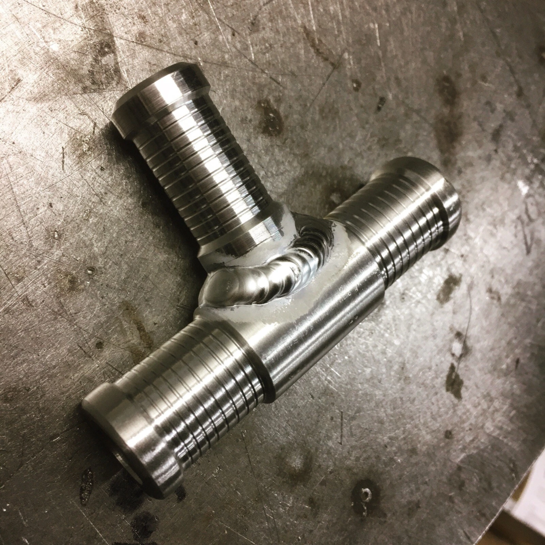

I fitted the SiFab version a few years ago, but it felt undersized for the hoses and a sloppy fit
18mm is difficult to find, these do a 19
https://www.merlinmotorsport.co.uk/p/aluminium-barbed-t-piece-for-19mm-3-4-inch-bore-hose-mhj-t19?v

Cast aluminium and 17.5mm at the barb.
Worth a try for £4.83 delivered.

Yeah, I'm not paying £25 for a simple T-Piece confused2
A fiver seemed like the right money to me, and being cast aluminium it should prove reliable, here's a link to the listing:
https://www.aliexpress.com/item/400...er_list.order_list_main.4.15c31802Py20c5
Also, the way I see it the expensive TiGed up version is only as good as its weld, while the substantially cheaper cast one has no welds to leak or fail thumbs

The £4.83 aluminium T-piece finally arrived today from China land.
And it looks good quaily too thumbs
I experienced minimal loss of coolant by simply deploying my hose clamp.
All fitted in 10 minutes, and I'm pleased to confirm it's a perfect fit.
I finished the job off with a carefully cut (hidden) foam block to avoid rattles and vibrational stress on the aluminium T-piece.
Happy with that, and for less than a fiver it's a known failure point removed for sensible money thumbs
