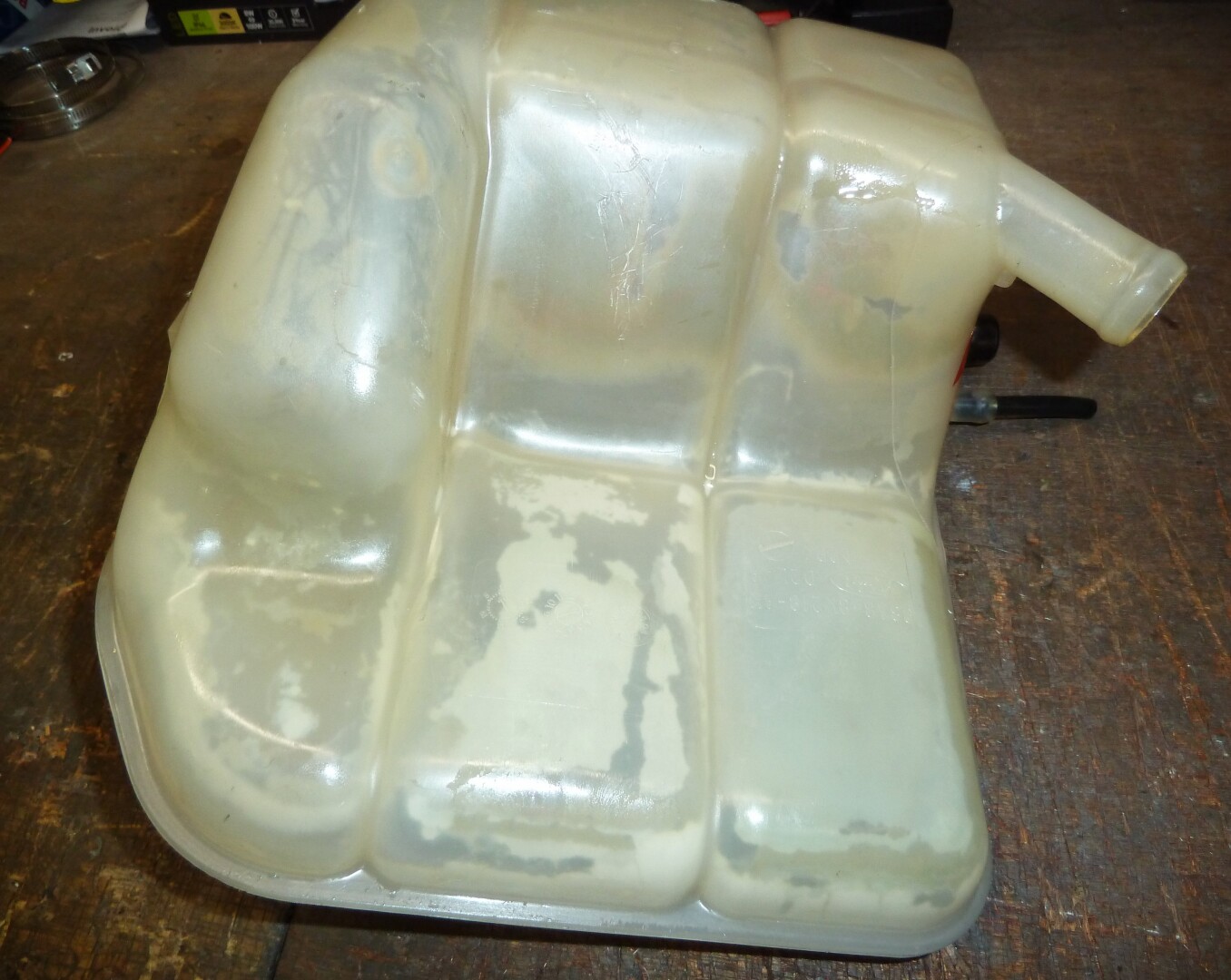

Just getting ready to put my Mog to bed for over wintering. It's a plus 4 2010 car with a Duratec engine. When doing the checks I noticed that the header tank, a Ford item had started to show some brown sediment sticking to the upper surface of the vessel where the Radiator return pipe enters, That's one of the two small pipes that enters on the medial side at the top. This is a sure sign that the coolant has started to break down, so a coolant change is required. Now this will be the second time I will have changed my coolant ie. the third fill from new.
So I prepared to change out the fluid. Mine is filled with the Motal Ford product, the red stuff! so I ordered 5lt of that and 10lt of distilled water to do the job.

But I was surprised to see the sediment issue my car had thrown up this time. Its low milage and well serviced. Thinking about it, it was probably due to the OAT coolant mix throwing sediment, (Looked much like a red wine that had thrown a sediment in the bottle), over the total life of the car. When all surfaces were coated the new sediment found it harder to adhere to the already coated surfaces so made their way to the header tank. Now the latest coolants don't hold an electrical charge, the older types do, in fact you can use a multimeter to read it! So, when the metalled surfaces were coated, a little like powder coating paint finishes, the sediment then remained in suspension in the fluid. Well, I don't know this to be the case, just a theory. The hoses incidentally were as clean as when new but the initial drain down produced a new looking coolant mix yet the subsequent clean with the flush washed out like filthy ditch water and took three more flushes to run clear. Over the years I have flushed many a system using the old hose method and didn't achieve much in the way of discolouration to the water. Since using Prestone for the last few years on our cars as they aged I have been very pleased with the results of how they cleaned the system...... however I was not expecting a 10,000 mile mog to produce anything much... Oh how wrong I was!

My Roadster went white sludgy in the header this year and after a couple of changes. I suppose at 20 years old things like this will happen. Only a patchy deposit on the plastic though, like condensation. The coolant looks the same.

Think it might look orangey because the new coolant is shifting the deposits in the engine and they were red coloured from the OAT coolant. Mine didn't show a lot of sediment but just small deposit areas in two places in the header tank. As I said when I initially drained the old coolant out it looked perfect, right colour, perfectly clear. It was only through experience that I knew I must have some level of yuk within the cooling system to allow the deposits to reach the header tank. What surprised me was just how much muck the flush shifted when to all intense and purpose it would to most look like it was a clean system.
