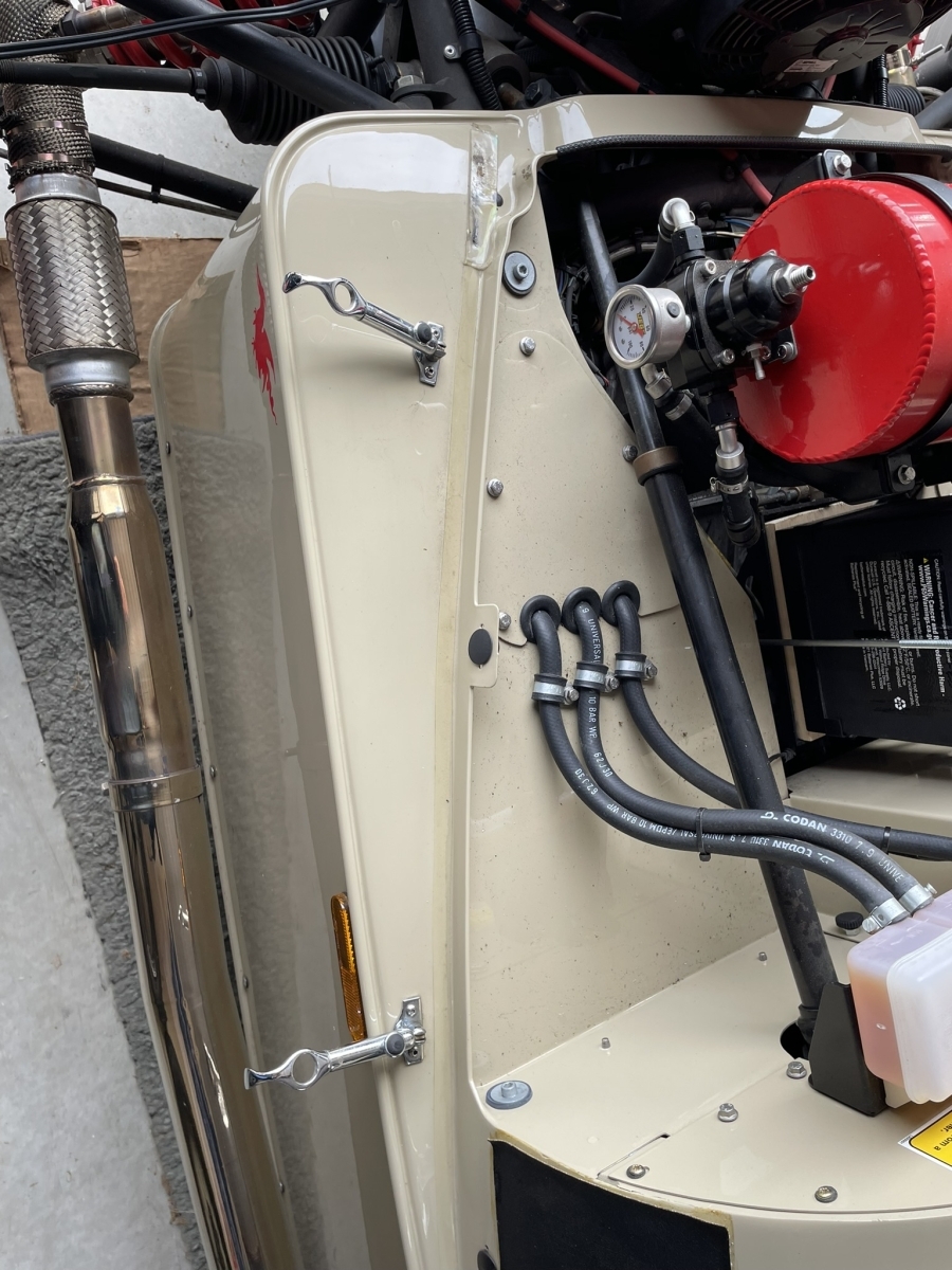

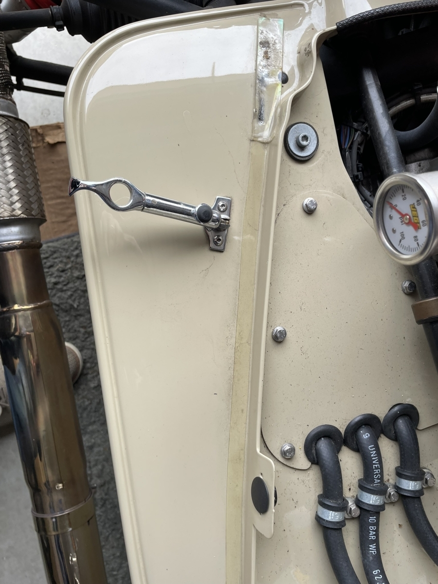

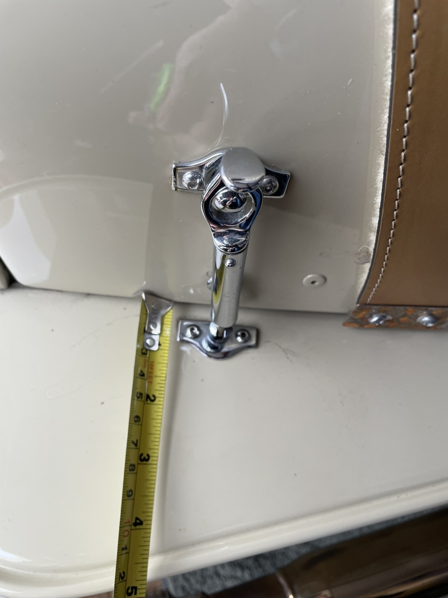

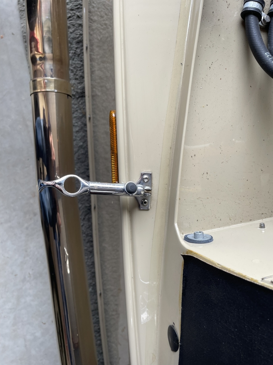

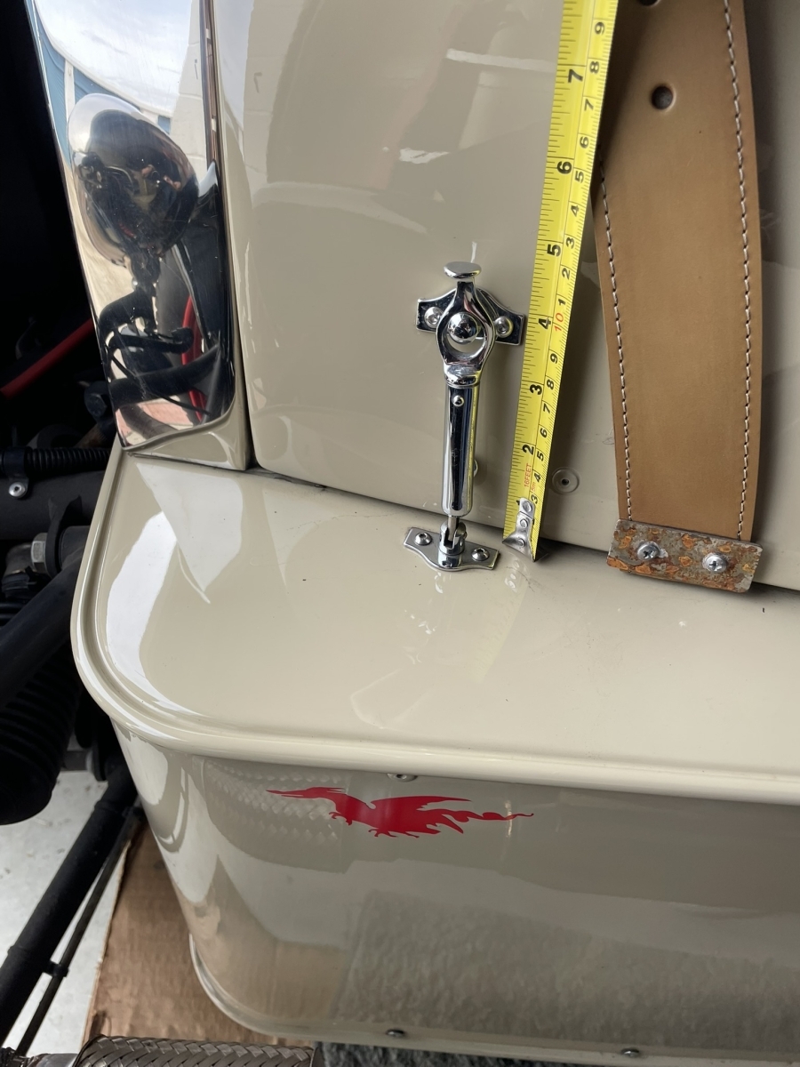

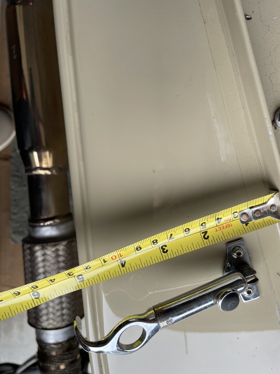

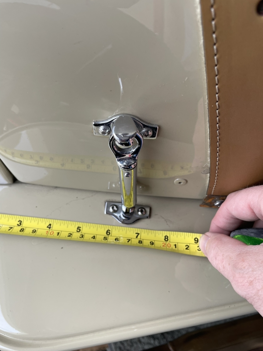

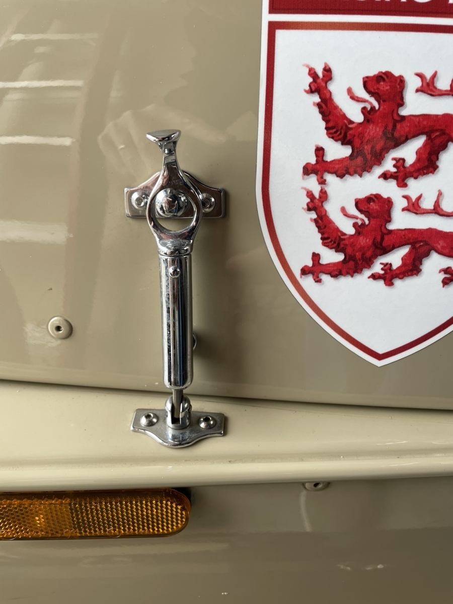

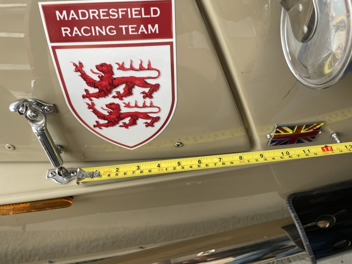

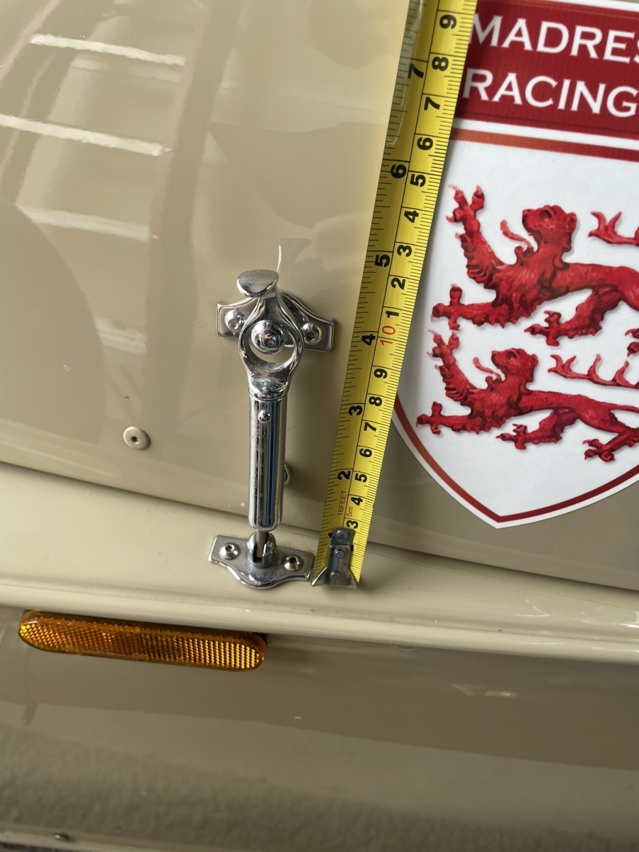

M3W Bonnet latch locations
Photos of the bonnet latch locations on the factory installed latches.

Thanks for sharing those Craig,
Probably worth noting that it is preferable if the little rubber bumpers on the latches should rest against the bonnet when installed as they help dampen vibrations. One of mine was fitted with a gap and that corner always vibrates.
I have neoprene padding at the front end but might have to add some thin pieces at the rear corners.
