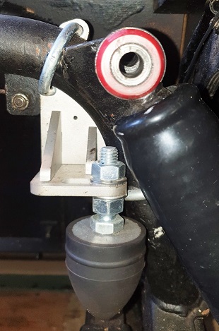

Thanks again for all the nice comments re the bump thingies and thanks René for your message.
Unfortunately, these aren’t the magic fix for all the nasty bangs and crashes that can happen at the rear of a trad. If the springs are in good condition, they can help prevent some of the infamous Morgan bottoming and add a bit of progressive stiffness to the suspension at the same time. However, they can do nothing for a car where the suspension is topping out under extension and producing that occasional disconcerting jolt or bang that some cars may have.
The tricky bit however is differentiating between the two types of events, bottoming and topping. In the heat of the moment when the car hits a bad spot on the road, the suspension reacts so quickly that you can’t easily tell if the issues is at the top or the bottom of the suspension travel, or even both. Fortunately topping out is easy to identify and deal with as it mostly because one or both dampers are too short. To establish this just whip out the top damper bolts, jack the car on the rear cross member to let the axle sit on the rubber drop stops and then try and re insert the top fixing bolts. If the damper’s top fixings won’t reach up to the mounting eye’s and you can’t easily insert the bolts, then most probably the dampers are too short and have been limiting the suspension. Unfortunately, this is not uncommon. Not only can it spoil your ride but will have been stressing all sorts of stuff that shouldn’t have been stressed

In the moment there‘s a lot to do, so no time for the MOG.
But I‘ve got the bumbstops and I‘m happy about their look. Now, the MOG is sleeping until February and so there is a lot of time for some work.
Thank you Roger for you help and fast service!
Greets René
Only for information: after Brexit it‘s clear some extra money to pay. At first I was surprised about 53,-EUR, but than with a look at the regulations I don‘t know how they do the bill. The official Tax/Custom information showed me more than 70,-EUR. So, happy with the bargain. And: for the good looking parts no problems with the money paid.
