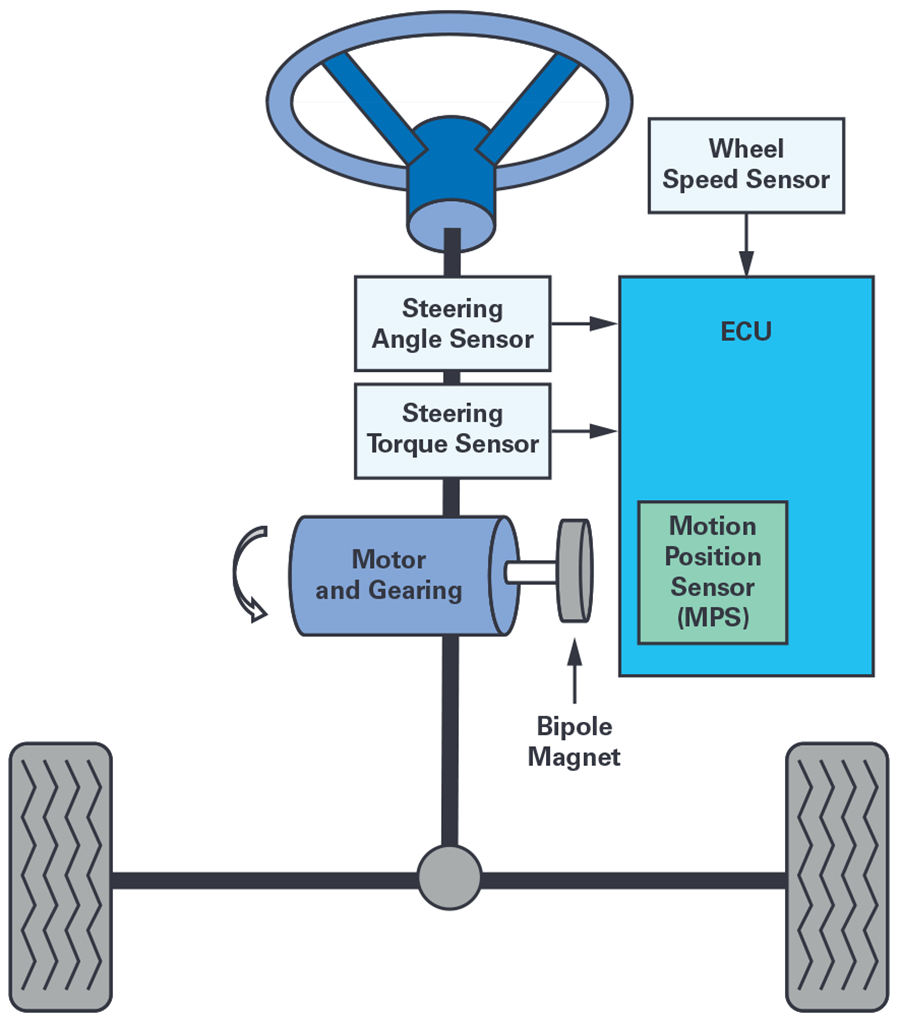

Thanks Keith. A little more info on the EPAS system factory fit on later 3.7 Roadsters, presumably Vauxhall derived and optional on Plus 4 of same era. The electrical connections are relatively simple just four wires on matching connector. Main direct battery power via 40 amp fuse. Ignition switched activation via engine fuse 18. BCU supplied speed signal decoded from CANBUS, and ground. Interesting that its speed sensitive. I recall others complaning their's wasn't but maybe true of earlier versions  . Below generic layout of column electric assist steering. ![[Linked Image]](https://i.ibb.co/LDTg9zdk/eps.png)

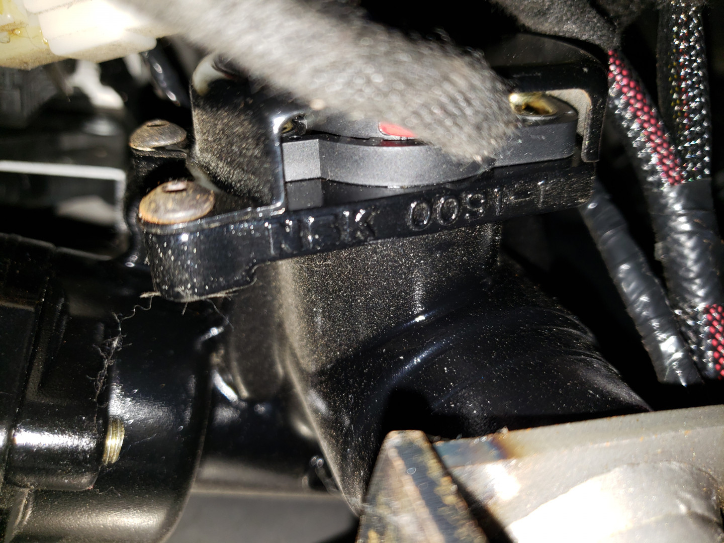

Mine's not speed sensitive Richard
I queried this with the Factory when it went in for some warranty remedial work (not steering related) and Mark B confirmed MMC's system is not speed sensitive or adjustable for level of assistance, but that the previous 'bought in system' was, via a propshaft sensor
I assume if we took off some of the footwell trim there may be a CE mark / maker label on the motor ?

Yep, there's some labels on the motor...wish I'd taken a close up during build  ![[Linked Image]](https://www.tm-img.com/images/2018/04/20/Tin-Shop-19.4-100.md.jpg)
