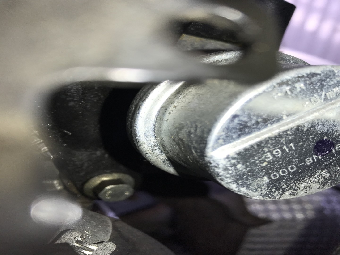

This is the sender on my 2011 sigma engined 4/4 from new
Always thought it reads a bit low. (3bar & 3000rpm) Even ? Allon Whites on delivery.
Think you are right low flyer Your ref would probably read about 4bar.
