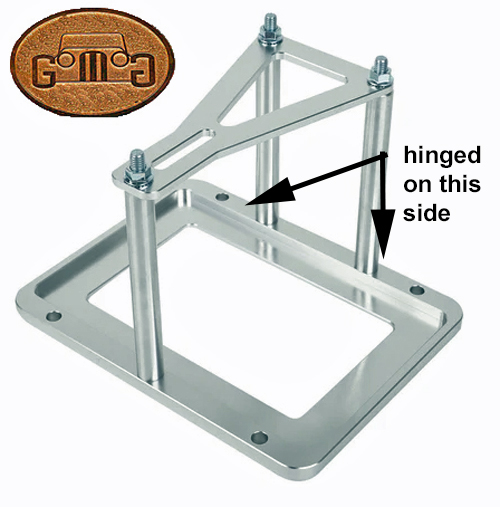

Access was easy. It is one of the features of the added tool bins I made in the axle area cover. https://www.gomog.com/allmorgan/rearstorage1.jpg
Battery Removal, merely meant buying a battery tray ]after very careful measurements. (very careful measurements cost nothing) and battery trays can
be had for 10 quid. I bought a fancier polished billet one shown below.for 50 whatever I hinged (use ss) the forward side at the tiny shelf (the shelves changed
size over time) or used the metal tabs that another other had, (shown above). The hoop suspension cars (post 1992...from memory) provide the front holding point.
Most hoops come with a drilled hole for the needed thread rod that I use with a butterfly nut. Loosen/undo the nut, and the battery swings on the hinge to the
ground. Takes seconds. If you have a later screwed down axle compartment cover, change it to the earlier removal method. As we see so often these days, not all
"progress" makes sense. wink
Lorne
