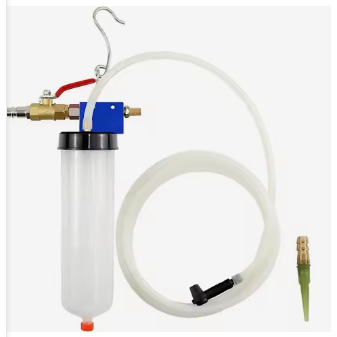

The hydraulic tappets are easily disassembled for inspection and cleaning; after reassembly, I put them in a sealed container filled with oil and I create a vacuum to purge them and allow them to fill with oil.
Bleeding the hydraulic tappet makes the initial engine start-up easier with easy start exhaust camshafts.
Some purging tools can create a complete vacuum with 8.5 bar of pressure; I measured it with a pressure gauge. The tool is readily available on AliExpress.
Some purging tools can achieve a complete vacuum at 8.5 bar of pressure; I measured it with a pressure gauge. The tool is readily available on AliExpress. The internal parts of the hydraulic tappet should certainly be identical to other tappets with different external dimensions.https://ibb.co/gZqwWyB1
