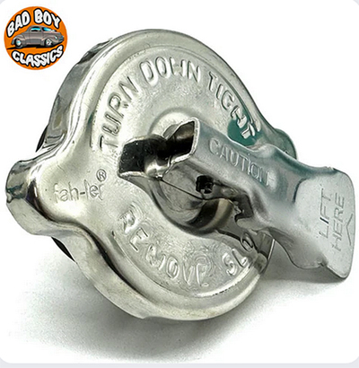

This cap seems to be available only in the USA. Is there a dealer in Europe thinking ?
Bad Boy Classics (a UK supplier), sells a higher quality (polished stainless rather than printed aluminum) version of such safety caps made in New Zealand (from Fahler) that I use. https://bbclassics.co.uk/collections/rad-caps
They seem to be on sale today.
