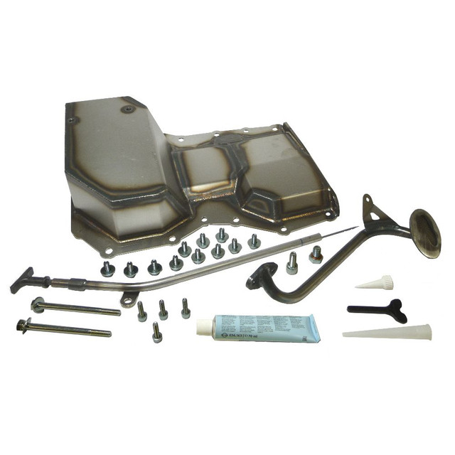

Have I missed any discussions on dry sumps? I assume Monty’s crank is still splashing around in a wet sump? If Monty does still have a wet sump then would you not be losing out compared to say a 420R at 8k RPM owing to crank drag. I know nothing about dry sumps but how much horsepower might be being robbed at the top end?

On the subject of dry sumping Monty, my thoughts are while great in principle it does add considerable cost and complexity. Cost and complexity aside, while there are a number of undisputed benefits in going dry sump it does also move Monty a bit further away from the usable fast road brief and a little bit too much towards a full on race car. However, on the track and especially as I use Toyo Proxy RRR tyres, there's a strong argument that says it would be a good idea to fit a baffled sump like this Duratec one from Retro Ford.
