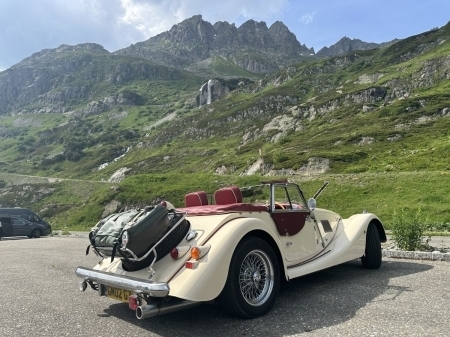

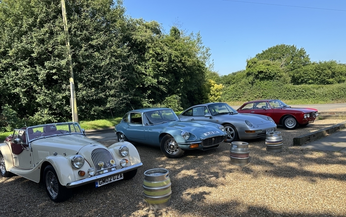

An eventful trip. From being stopped at a police check point to swimming in a mountain stream (yes it was hot !), we had a great time. The car never missed a beat over 1600+ miles and the only issue we had was a sticky throttle actuator, (made life interesting doing 4500rpm going down the Susten pass !). The Alfa died on Day 5 and was successfully repatriated with driver. The e-Type died on last day with similar repatriation. The Porsche limped home !

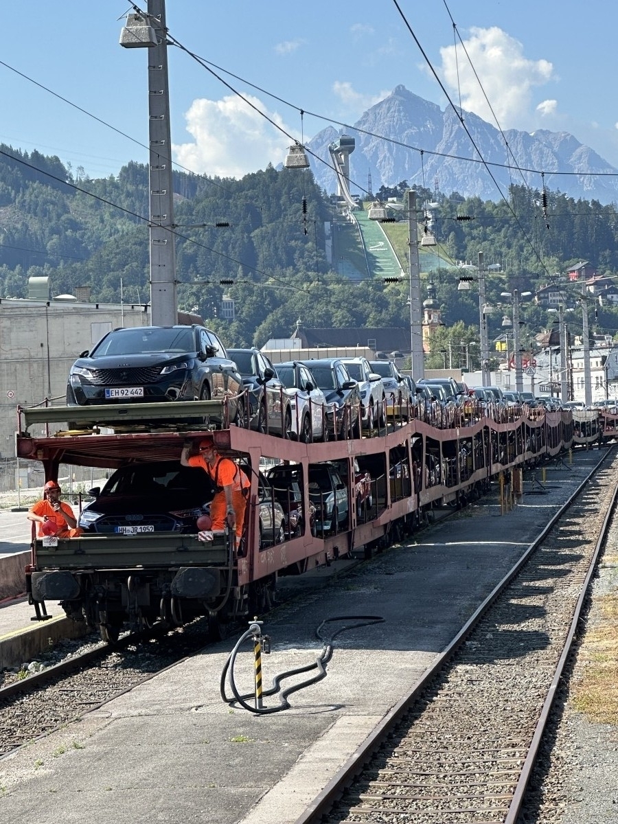

I will post a couple of final pics in a new thread along with details/experience of the train to Innsbruck.

Thanks for sharing the pics and a bit of the story relative to your in Switzerland trip with friends.... could you provide more info on the mechanical maladies the others in your party experienced ...? I am sure there will be others than I who are interested in such matters... If not, no problem..

No problem. In short:
The e-Type had a power issue which was fundamentally a result of perished hose/loose jubilee clips affecting the amount of air getting into the engine. In addition brakes were overheating and sticking on, and the exhaust needed some temp repair as it had been “caught’ when loaded onto the train.
Fortunately one of our party (the son of the e-Type’s owner), is a very clever chap. The exhaust “rubber straps” had been broken so he jacked up the box, and using 2 “curtain pole rings” (purloined from our first hotel), fashioned fix. Basically using a pair of grips to hold the rings, and a large stone to hit them into an oval shape he was able to hook the exhaust back into position. The next day at the local garage in Tujetsch the owner couldnt help us as he was booked out, but provided sufficient hoses etc to replace some of those that had developed leaks. All worked well for 2 days but the main fuel hoses ? (braided ones) began to deteriorate.
The Alfa developed a misfire which after we diagnosed it as a fuel issue to no. 4 cylinder we hoped to get fixed at the local garage. Unfortunately he couldnt find the cause so as we were heading for Lucerne the day after we found a garage who specialised in classic cars and told us to come over along with the e-Type (for brakes) Within yards of reaching the garage the clutch went right outside……..a Classic Alfa specialist ! Clutch slave cylinder piston replaced and misfire resolved in 3 hours, The latter was an issue caused by wrong plugs being used ! No real luck with Jag but off we set from Lucerne to Nancy.
Next day Jag was struggling for power but limping along at 50-mph. I was ahead with a very roarty Alfa but we came off the dual carriageway to discuss the e-Type. As the Alfa stopped the slave piston failed again. Suspicion was something in the slave cylinder was “chewing” the piston’s up. Anyway decision made to sort out repatriation.

I thought you were getting the train to Düsseldorf. Was Innsbruck then an extra leg. Depending on cost a car train to Innsbuck would be good for Slovenia trips. If it’s not too forward, love to know the cost. Seems like you only just went, stay for longer next time and revisit Slovenia . Best MM

Depending on cost a car train to Innsbuck would be good for Slovenia trips. If it’s not too forward, love to know the cost. Mike, Chris mentions more about the car train on this post, including costs.

Doesn’t instil confidence does it ? CWC many thanks for taking the time to provide such interesting and educational detail as to the realities of touring in Classics, very much appreciated.... Been there done that and have a couple of stories which I have shared in the past... (-: I note that it seems you may have omitted to share the fault issues that the Porsche suffered.... Any clues available..?

Unfortunately I am not sure - other than the air conditioning wasn’t coping well (First world problem 🤣). I will try and get some more detail but as the significant issues were with the Alfa and the e-type, I failed to get to the bottom of that one.
