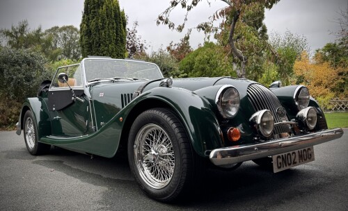

So I had requested my local Morgan dealer fit new main springs and rebound springs, steering bearings when doing the kingpins.
They fitted New Elms/Rutherford short 105lb springs and same 200lb rebound brand. I have the excellent wolf dampers already.
The dealer noted when they removed the original green spings they were very short compared to the new ones, and contacted the supplier who confirmed correct parts supplied.
When I got the car home I noticed that the car sits 1" higher than before at the front, and the crashing is gone thankfully. I jacked up car safely and was going to clean excess grease and I noticed today that when unladed the rebound springs are heavily compressed, and the mains are bowed on each side. The bow doesn't appear when laded on ground as far as I can see, the rebounds are less compressed.
I wondered if there could have been longer springs than intended, hence the bow or is this normal.
Dealer suggests they will settle down, but I'm not sure they will lose an inch, the bow concerns me, but I'm not familiar with these set ups.
Any help would be greatly appreciated as it cost over a not insignificant £1300 to do and before I contact the dealer.
This was the suspension when I got the car before I put the wolf dampers on:

From your pictures there is no doubt the previous main springs had both weakened and shortened born out by the gap above unladen rebound spring. The ideal here is with car static the stub axle should be gently resting on the rebound spring but still allowing it to be twisted just. SSL offer their RS kit that includes main springs with provision to adjust pre-load on same such that this ideal state can be acheived and maintained over time, together with rate risers to prevent bottoming out under heavy load (bumps).
With the car jacked up the rebound springs are always compressed to some degree as there's no load on main spring, so this observation is irrelevant. Ref above, what is particularly important though is any compression of rebound springs when car resting on its wheels. Perhaps you could check and report on this. Reason is that the two springs either side of stub axle behave together as if in parallel when they are both in play adding their spring rates. If rebound is compressed to any degree this means you will be driving a car with a massive 305 lb/inch spring rate until an undulation momentarily compresses main spring enough to release pressure on rebound, when spring rate will return temporarily to main only rate of 105 lb/inch. This hard then soft ride is the antipathy of ideal rising rate suspension giving the car a wallowing ride into corners.
Ex factory Morgan tend to chose main springs that provide a little (less than ideal) pre-load of rebound springs such that as mains settle in the rebound pre-load diminishes to ideal of just on zero but this can take some time (if ever) leaving owner with over firm ride in the meantime. Of couse too much play of rebound springs when static is suboptimal as well leading to excessive rebound travel (bounce) over bumps. Collectively this explains the popularity of SSL RS kit mentioned above.
Finally I wouldn't worry about the bow in main springs particularly as you suggest its not present with car resting on wheels. BTW I understood 95 lb/inch was standard rate for Morgan 4/4.

This is the state of play when car is on ground and wheel turned, there is little discernible difference in rebound spring one wheel or the other when turning.
The steering damper is much larger than what was fitted before, and the damper is now about 1" extended on rest from before.
The ride height being 1" higher is bothering me as rear is visibly raked lower now.

From your pic the tyre to wing gap looks similar to mine?
Can’t tell for certain but I looks like you now have some steering bearing above the stub axle assemble and under the main spring that isn’t present in the ‘before’ shots? Or is it there but just dirty?

Well spotted. It was there but smaller. This one seems twice the size of others, and I think is adding to the issue. That is interesting on your ride height, mine was always lower, like the rear.
