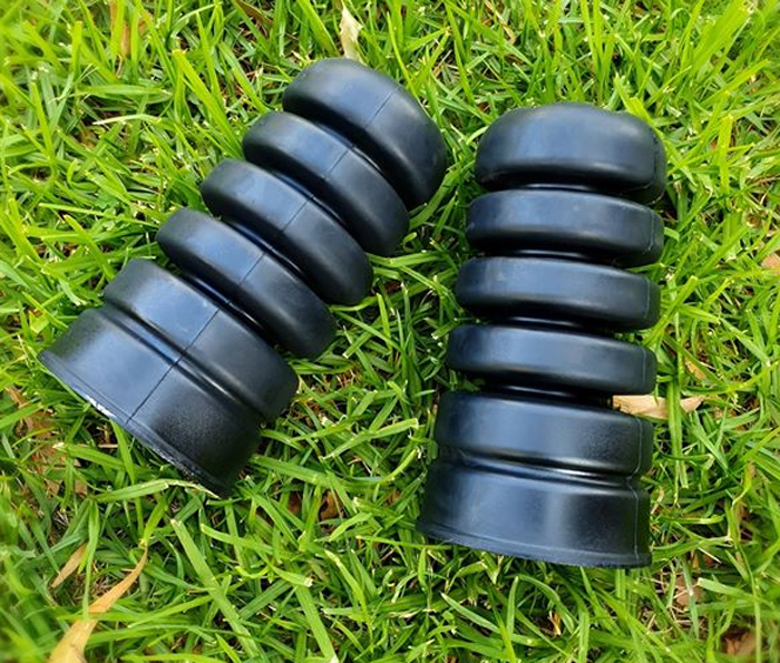

We can do that a better way hopefully. perhaps. AND cover two issues with one inexpensive forever part. To whit" The industry standard used for generations now is to use a normal bump stop (duh!) preferably made in modern microcellular polyurethane, foam, or specially slotted elastomers, or neoprene, inexpensive and permanent. (I did some homework for you wink ). Look below. I picked out one of many from a goggle search. Try it. " progressive bump stops " as the research term.
It is certainly more logical to use a bump stop as a bump stop rather than a coil spring for that task. They could also be made to cover the exposed lower part of the kingpins and do away with. Ideally they would fit snuggly around the kingpin (ID 1") and even made to extend up when uncompressed to cover the kingpin exposure. They come in all colours so those who wish could make whatever statement they wanted. smile So why bother discussing the effect of cut or uncut rebounds? Frankly I don't like them much cut or uncut. ooo We should be smarter than they are after 115 years. But as I noted, the Factory believed that WE found them charming, likely because we over-dwell on them and spend ridiculous sums trying to sort them not counting the angst speaking to this area.. 😂
