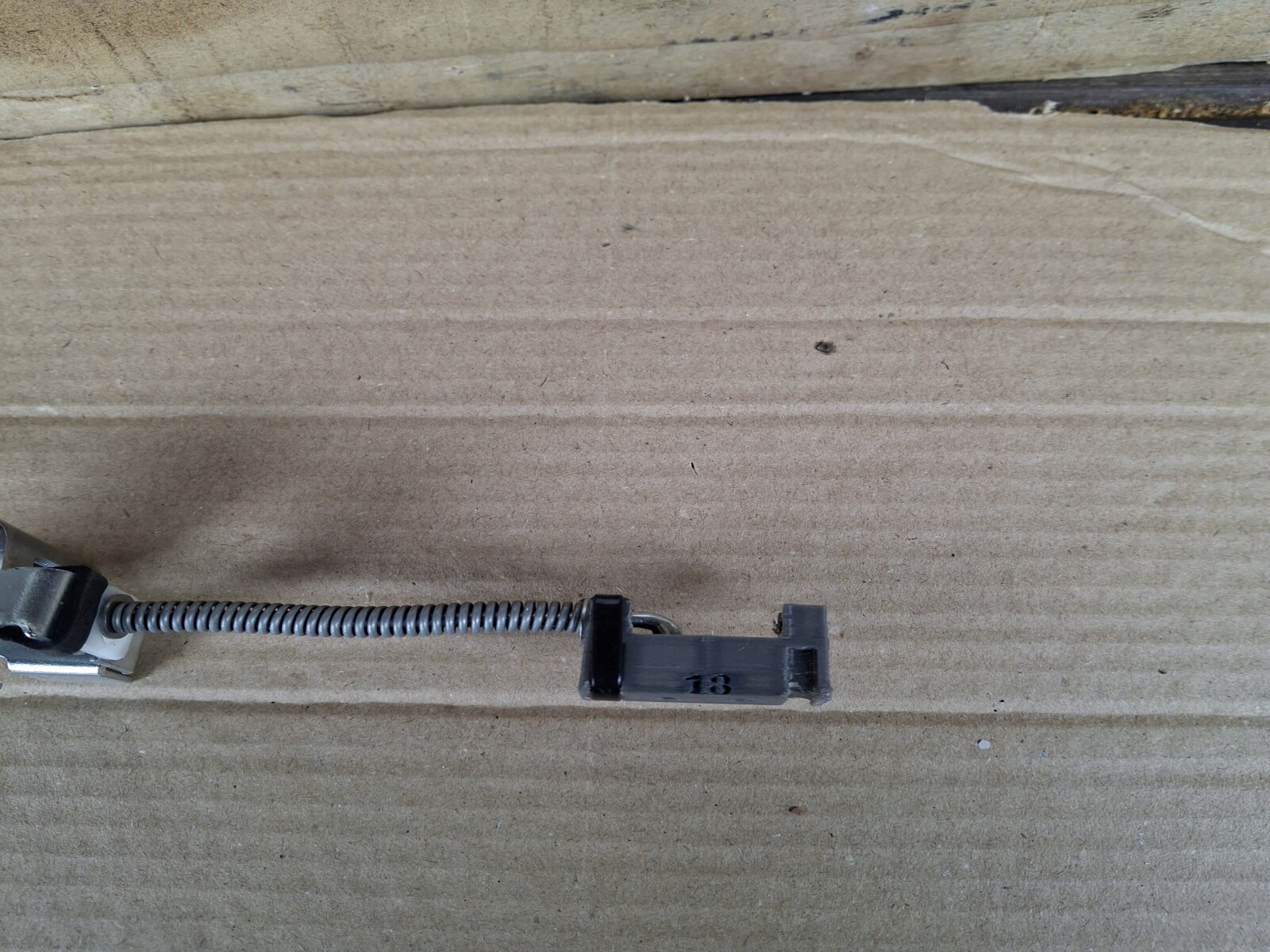

We already have taken many hours developing a suitable replacement, the redesigned clip is also 3D printed but it has been modified and strengthened to prevent the known issue of disconnection and/or warping of the connector, it is also of a suitable 3D printing material to take the forces. FYI the first 3D printed units using normal 3D printing materials failed. Version 18 will be going into test mode in two weeks time when my car is available.. It will then take a few weeks of testing to insure the design works. This will also test the actual ID of the clips holding channels, which have to be the right dimension to hold the rod size that Morgan uses.
Its a free market and up to everyone which to choose.. the idea behind the redesign is to overcome the issues with the present design and the non availability as such from Morgan.. The modified unit shown on this post is way more expensive due to the input time of the 3D developer.

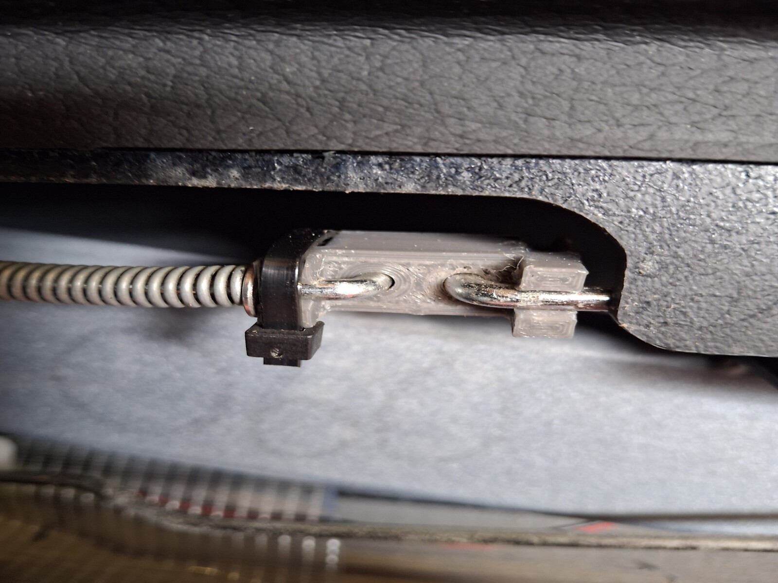

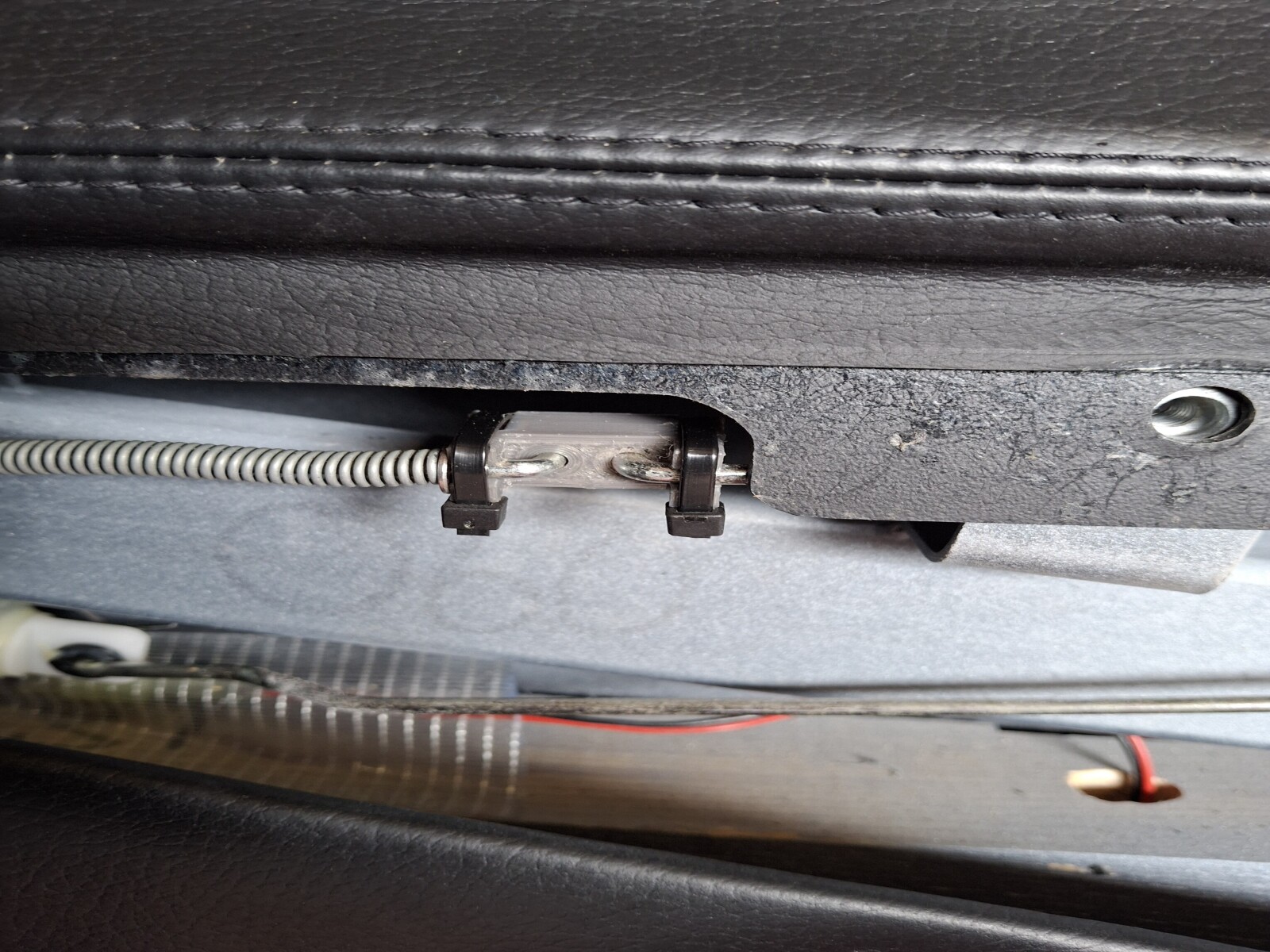

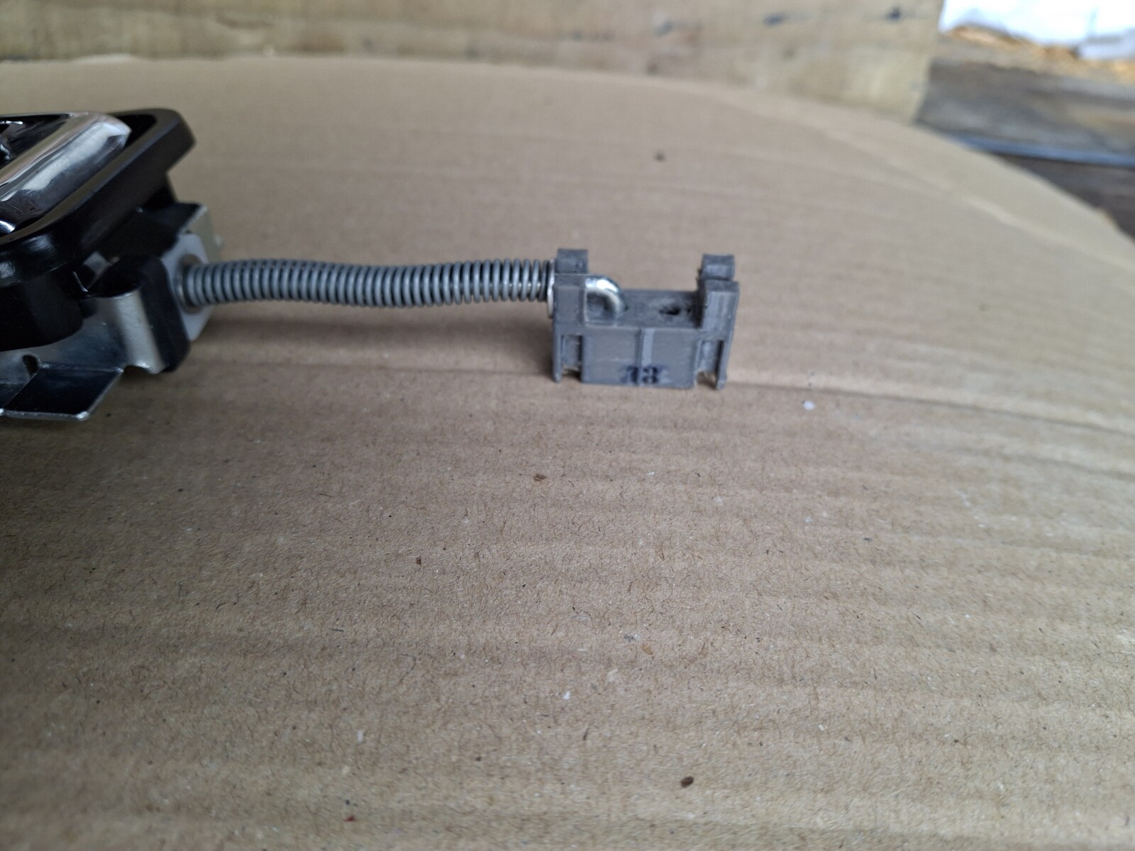

I have fitted the Mk 18 door clip into the Plus Six drivers side, it fitted perfectly, a strong push fit and clipped perfectly into place. The designed tie wrap channels work well to locate and hold a tie wrap in place for secondary security of the rod in its clip, although the fit is very good and some may prefer not to use the tie wrap option.
I have attached 4 photos of the clip in its rods and also fitted with tie wraps, note the position of the tie wrap "heads", these were positioned to ensure it did not catch the door card when the interior door catch is operated. I have test opened about 100 times so far and all looks good.
I am chatting with Mark to see if the design needs any other design tweaks..
