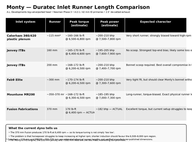

I've been studying runner length today, and the results are quite revealing. I've crunched some numbers via a few runner length calcuators, and assuming we're keeping Monty under 8,000rpm, which we are, the optimal runner lenth that keeps coming up, is... 300mm.
However, there's under-bonnet packaging to consider too, for example there's no way on God's earth we're fitting 300mm long ITBs under Monty's bonnet, even with a bonnet scoop! Having measured up today, the maximum runner length of a set of Jenvey individual throttle bodies fitted with a low profile foam air cleaner, that would fit and still allow me to close Monty's bonnet, are 160mm, so a long way off 300mm!
I've also just measured the long curved runners on my Fusion Fabrications inlet, they're 370mm, all the evidence suggest they're perfect if you want to stay under 5,800rpm, but they're 70mm too long for an engine we want to keep making power out to 7,800 rpm.
To make the evaluation of all the induction options more clear, I've created the following table.
And assuming we can make it fit and still close Monty's bonnet, it does seem like the Fab9 Elite Manifold would be the ultimate compromise.
It theory, it should give us this.
Monty should retain his excellent mid-range punch, but at that same time now keep piling on the horsepower from 5,500 rpm out to 7,800 rpm tops where he'll be making somewhere between 210hp - 220hp. I now think the Fab9 Elite intake is the way forward, but fitting it without a bonnet scoop is looking like it'll be very touch and go!

Have you considered a bonnet extension kit similar to Librands or have something made to lift the bonnet out more. It may save you having to modify the bonnet https://www.librands.co.uk/products-view-238.html
Hi John, the challenging area is the leading edge of the bonnet, not the trailing edge. I need all 180mm but this falls to 150mm due to the bonnet taper frown
TBH it's the same challenge as fitting ITBs, only less extreme, Morgan solved that one with a bonnet scoop, which I'd be happy with if it was'nt for the cost of having one made, and painted.
It's very close, but currently looking like Monty's bonnet will foul on the Fab9 Elite's throttle body.
And foul it before I can engage the front catch, my calculations say I only need 30mm more clearance, but the manifold really wants trial fitting before I know for fure?

The Fab9 Elite is a two part design with a plenum that tapers smaller towards the opposite end to the throttle body. The 10 bolt flange that allows you access to the inside of the plenum looks symetrical to me, so in theory you could rverse the plenum/throttle-body orientation relative to the four runners.
This reversal idea is an interesting possibility for Monty, with the throttle body at the opposire end and now facing to to the rear, the plenum taper works with Monty's natural bonnet taper, rather than against it.
However, the next challenge would be having sufficient space to fit an air filter to the now rearward facing throttly body. TBH, a forward facing throttle body would be a superior setup for a number of reasons, so it's really down to the bonnet to throttle body clearance, or just fixing that issue if it arrises with an expensive Supersport bonnet scoop.
