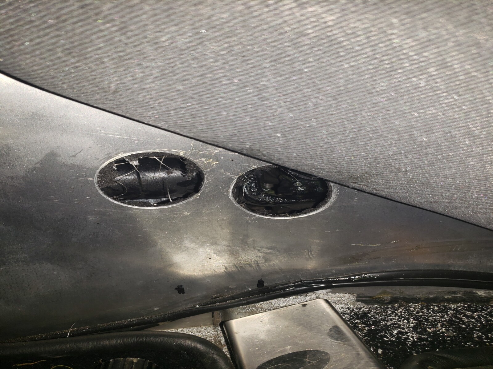

jon, I cut a hole in the gearbox tunnel . It gives far easier access

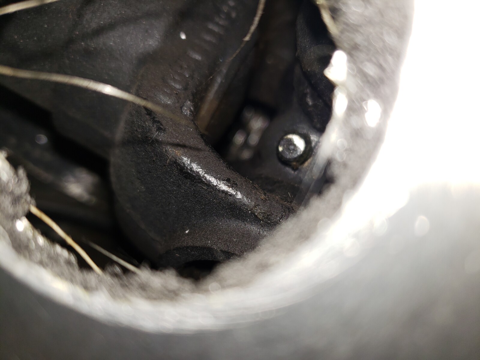

Jon, pictures of the holes I made. In reality the front one is enough. I can't find my write up but I did put a thread on here somewhere.
