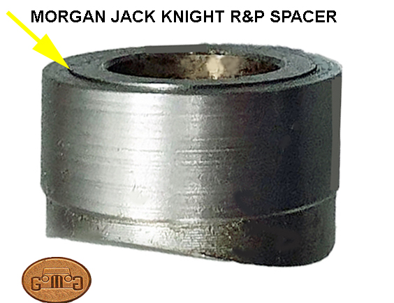

1. JK centre gaiters are extremely flimsy, merely laminated silicone over a mould. The two all important spacers at the rack centre have a raised section in their middle which never shows up in the schematics. These raised sections stop the silicone from being pinched by the plates when you bolt the assembly back together. If not, they soon split and leak, a MOT failure. I have added a picture of a similar spacer below
