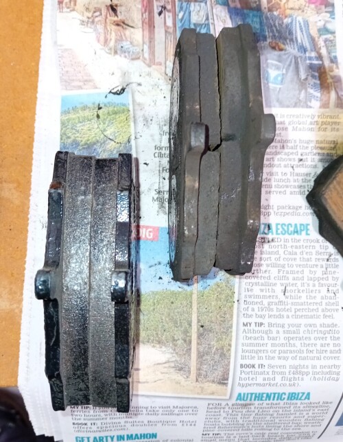

Ditto, but after at least 35,000 miles on the old EBC green stuff pads found a lip on them all, indicating both calipers spaced around a millimetre too far out from discs doh
Big improvement on bite though after swapping EBC green stuff for Mintex MRM1802 compound.
