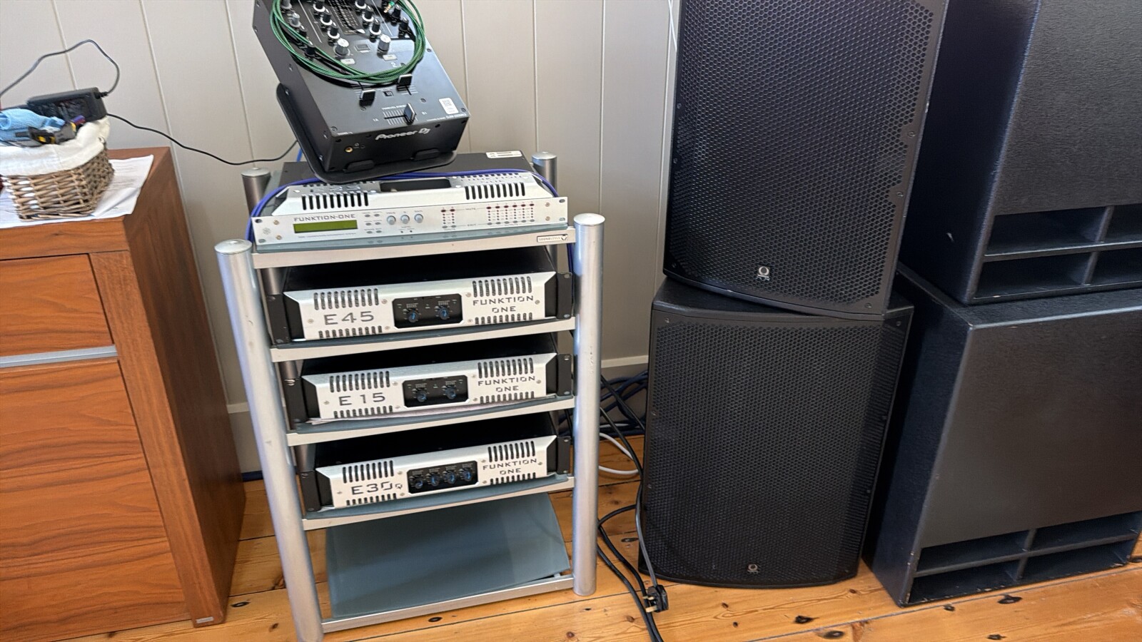

Part of my home system.
There is no such thing as too much bass (as long as it is good and not flabby and nasty)
