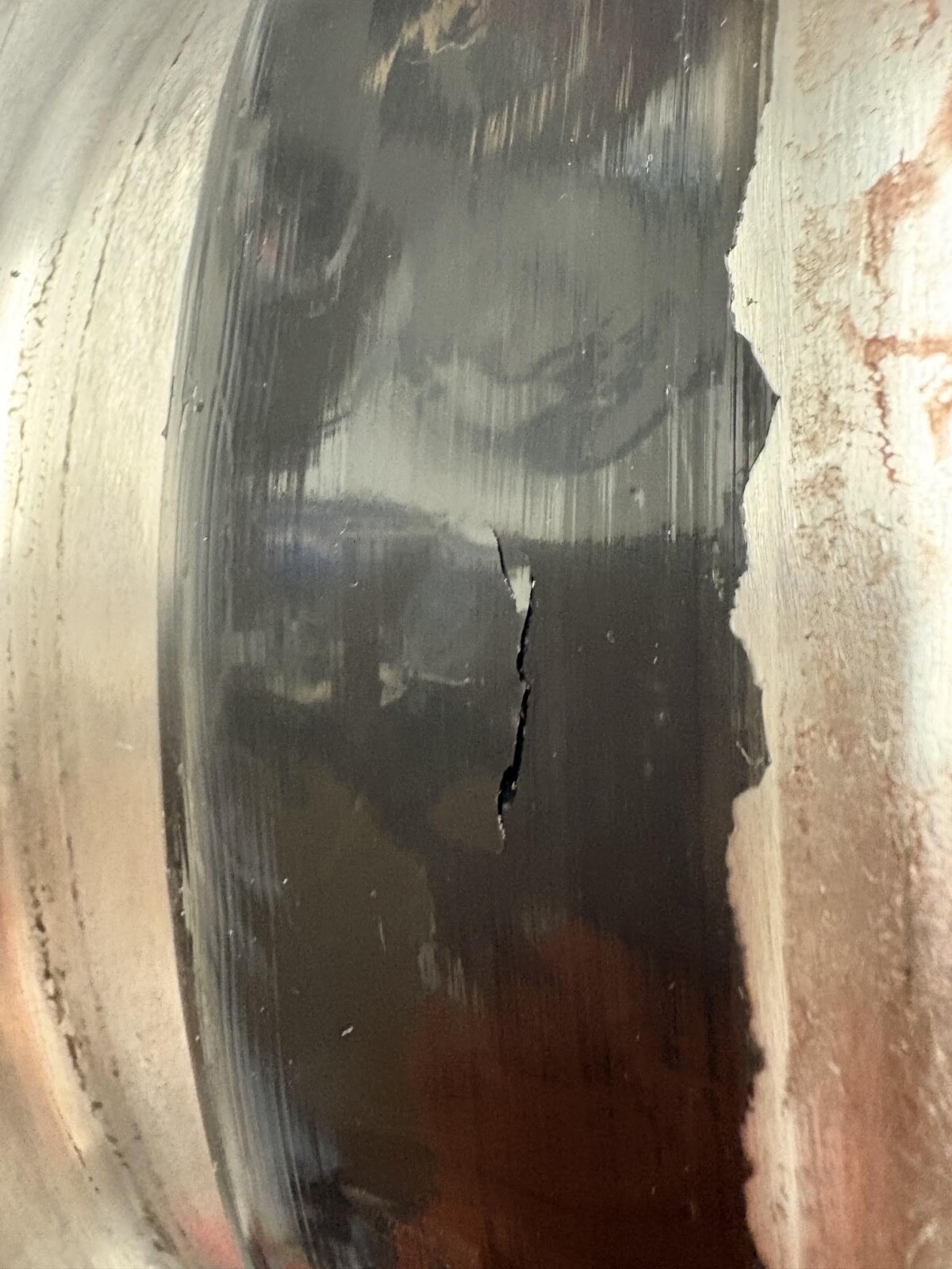

Plus Four developed a slow puncture. Stainless wire wheels. Air is escaping from a spoke nipple ( behave yourselves!).
Phoned MMC servicing to get details of how the wheel is sealed. A layer of silicone is spread over the spoke area and smoothed so it resembles a rim band.
Got my trusted tyre shop to remove the tyre. Silicone layer visible as they described. Spotted a small break in the silicone matching the leaking nipple. A bit odd as to how it occured but no big deal. Advice from MMC was to reseal with silicone, let it set fully then refit the tyre. Mark the tyre/wheel to get it back on to minimise rebalancing. The silicone is black and luckily I have some to match.
So, I'll reseal with silicone and get the tyre refitted after 24 hours to allow curing of the repair. I did consider fitting a rim band as belt and braces but will just do a silicone repair first. Gomog has a section on sealing wires that shows this silicone method.
I'll take photos of the wheel for reference.

Steps.....
Checked tyre but no damage seen.
Made up some soapy water. Poured into area where tyre meets rim. No bubbling.
Sprayed soapy water onto valve. No bubbling.
Sprayed spoke nipples. One showed bubbling so a leak.
1/4 turn tightening made it worse! Backed of 1/4 turn to original.
I've just resealed the small damaged area with matching black silicone, pushed into the tear and a layer spread over the area. Small matching dab put on at 180 deg opposite to help with balance but probably not necessary. Waiting 24hrs min for it to fully set.
Tyre was marked to be refitted as it was to aid balance so tomorrow/Friday I'll get it refitted. Photos to follow.

Photo of leak.
Plus Four MY23 Furka Rouge
Posts: 5,485
Likes: 477
Posts: 5,485
Likes: 477
Originally Posted by sospan
Photo of leak.
The resultant question would seem to be, why did the crack occur...? Expansion and contraction of a spoke relative to any difference in adjustment thereof between it and the others...or what..?
