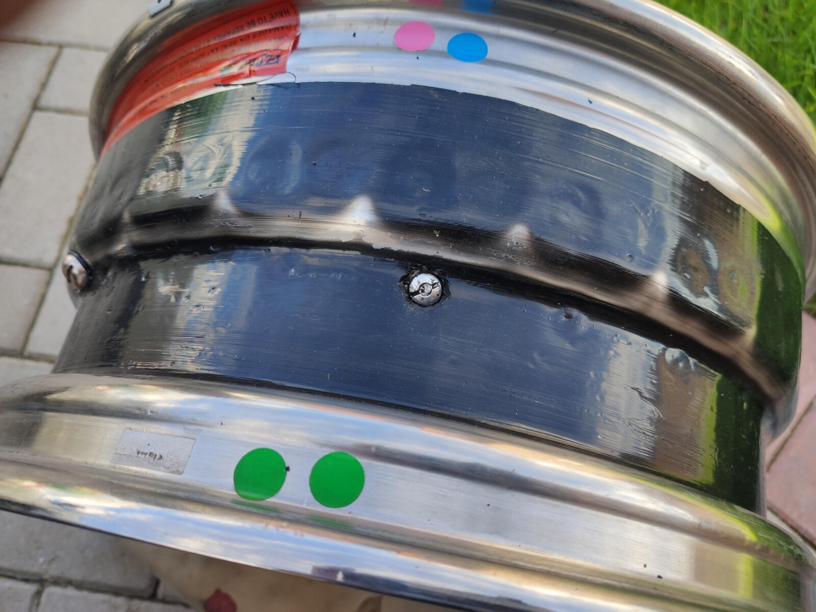

Originally Posted by sospan
Photo of leak.
Having er hum, adjusted the spokes slightly on the two rear wheels of my Roadster and suffered the consequences of damaged seals/deflated tyres, I can categorically say that your damage is not consistent with the localised damage mine suffered - see below after prep for replacement sealant. As Jon suggests its certainly been caused by clumsy tyre replacement. Although I was able to repair the damage on both of mine, that long stretch would need to be completely dug out and even then may need complete renewal as I note the edges have been damaged as well. Worth calling MWS for advice noting they can supply the correct Dowsil sealant. There are videos on complete seal replacement but its a big task removing old sealant first. Again MWS can perform this service.

A few years ago, my local village garage changed all 5 on my Roadster. They were careful but still damaged three seals. The tyres removed from the inside, not the outside, as I recall. Anyway they had some black silicon, and cleaned up the cracks, which were localised. Left overnight, and they have been fine ever since. I left the Roadster in the garage and just took the wheels down, so it wasn't a problem.

An inner tube was suggested by a wire wheel specialist in Cardiff. A solution BUT it means not using the matched stainless valve.
I am going to fit a rim band over the original sealant. As a quick test I might try Duct tape. A mate who was a pro motorbike racer for a top end team did that and no problems.
The existing silicone sealant is quite thick and it does look like the damage was done during fitting a new tyre. I can't see how not.
I want the car back on the road asap for some runs so a full clean, re-seal and rim band as a proper later job.
I'll get the rim band, silicone and make a smoothing profile ready. The cleaning will be the key to a good job.

Sospan it's not that easy, As John said a large-ish patch is needed to be repaired for it to be successful using silicone and the close proximity of the spokes sort of prohibits this, couple that with it being a specialised product and it'll end up costing more in time and dosh before you eventually get it sorted properly. If you have a spare just courier it to MWS rapped in good cardboard, It'll be returned all beautiful in an MWS box. Many Mog's don't have a spare these days, It's coming up to the bad weather so I'd just rely on the recovery option if the worst happened!

I had a leak in a tubeless wire wheel on my 2005 Roadster. I researched the recommended repair process and it sounded way too complex. My recollection is it involved removing the old sealant and replacing with a specialist sourced sealant, with a particular application required to insure a leak free wheel. I got ahold of MWS, the supplier of the wheels and they said "put a tube in it." I put a tube in it and haven't had any trouble since. If I would have known that some regular silicone sealant was the answer, I would have avoided the tube, sealed it up and been on my way!
