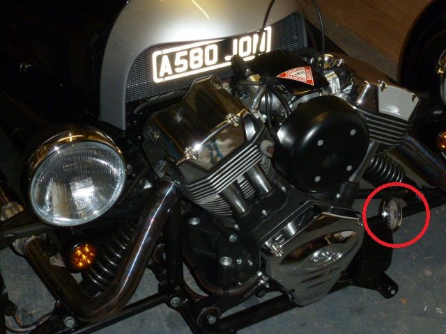

Suggested it earlier so I'll start with an nice easy one.
Number plate relocated to a new home, and the tax disc moved.
Currently waiting on an adjustable badge bar to fill the gap left by the number plate mount.

That looks surprisingly good, Asbo.

Yes, I like it! Front plate is still present, but in a much more subdued location. Since Michigan does not require a front plate, I am hoping to get my hands on one of those classic black UK plates like yours, but that says MORGAN in white.

I like that, nevedr thought of putting it there.
Where have you mounted the tax disc?

Classic motorbike tax holder, bent so it can be seen from the kerb.

Yes I see it now, I made a right angle bracket for mine so that it can be seen from the near side. I mounted the bracket behind the number plate mounting plate.
