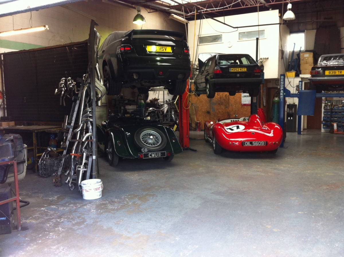

This morning I trailered the car round to Hayward and Scott to get the exhaust fabricated. There were some other interesting cars already getting sorted out. Anyhow, this week will see the exhaust manifold and side exit system fitted. Which leaves getting the ECU set-up next Monday.
This is handy as the TyCroes final race regs came out today.... We're number 20 and 201.
