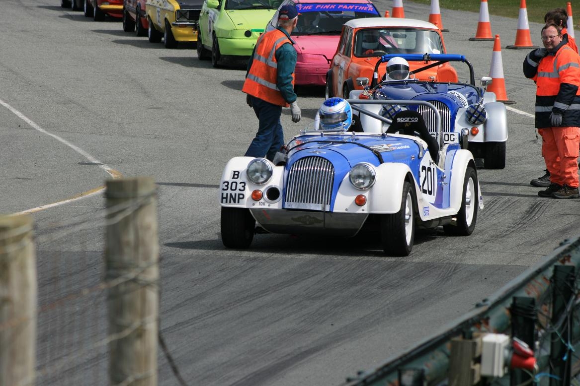

Here are some pictures from the weekend...

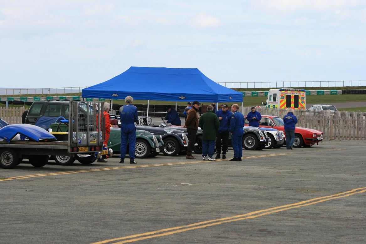

Plenty of Morgans in the paddock for Saturday.
This weekend there was going to be 3 cars in our class (Class 7 - upto 2000cc Modified 4/4) including another freshly finished car a Rutherford Lightweight with a Zetec E with variable cam on a Magajolt ECU.

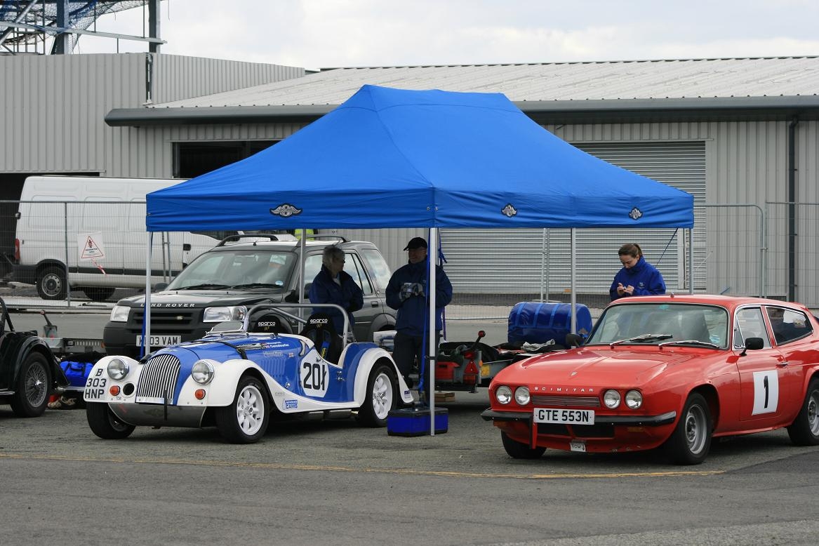

We set-up our paddock tent and made ourselves at home.. just in case of the rain.

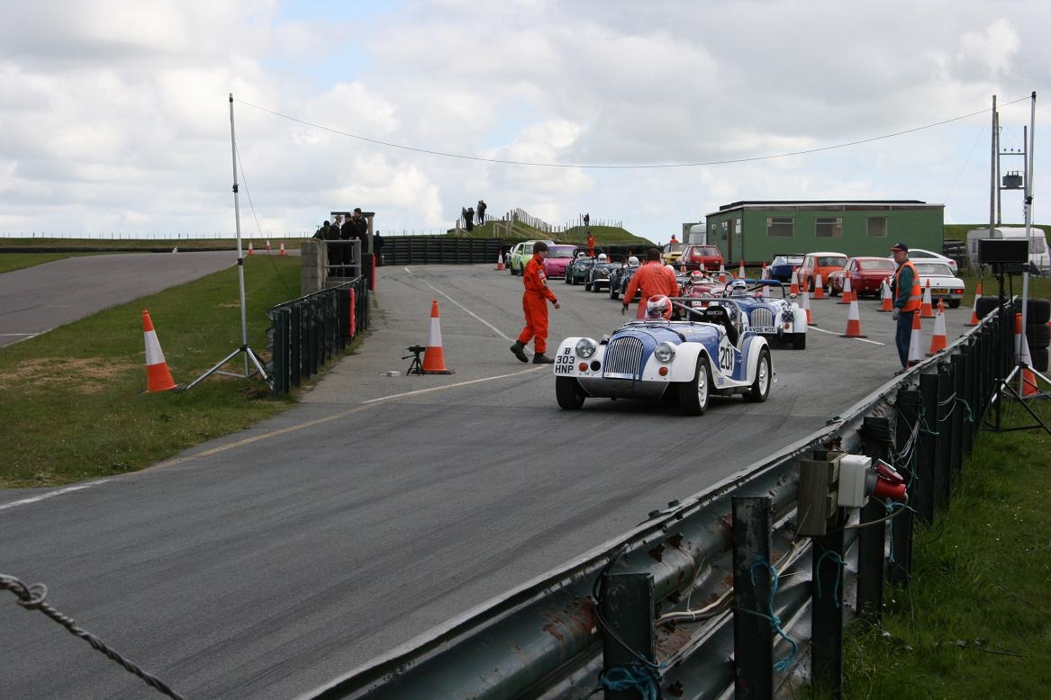

It was interesting getting used to the clutch when launching, the wheelspin was very smooth - as it looks. Missprint was up first.

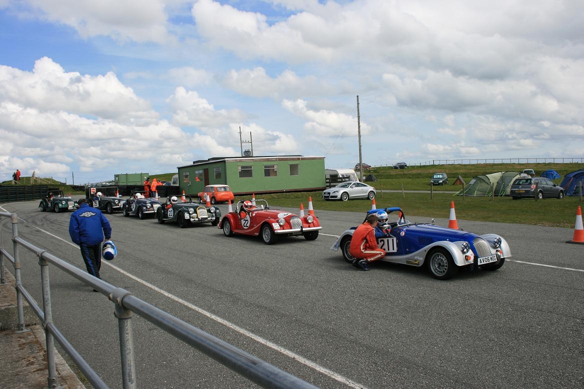

Morgans take over parc ferme....

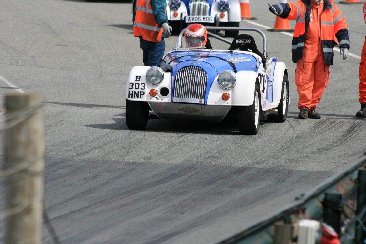

Next up.. my turn...
