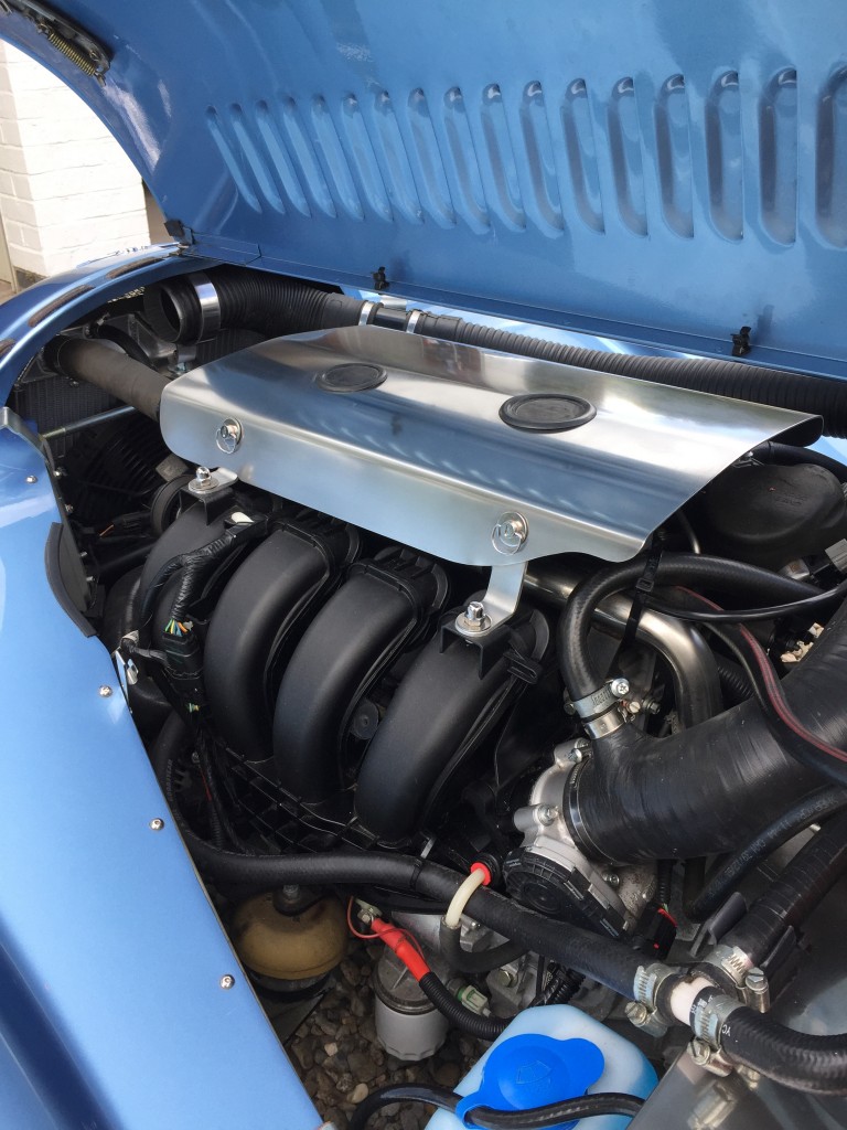

My home brewed engine cover. Cut from a 500 x 500 x 2 aluminium sheet, bent round a 50 dia wooden stake and fixed with some spare QD Dzus fasteners I had lying around.
