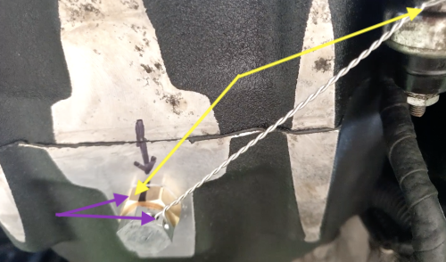

Therefore, I was left with little option but to fit an oversized sump plug. I used a M15x1.5 oil sump repair kit (Laser 5227) to cut an oversized thread and used one of the kit’s M15 sump plugs. [Note - ideally I would have used a M14 kit but I needed to use the M15 one because I had already oversized the hole for the helicoil misadventure.]
I found an 11mm ring spanner was ideal for turning the tap while cutting the thread through the crankcase. Obviously it was important to ensure that the tap was perpendicular to the crankcase and I took it very slow with plenty of backing up.
By chance, the copper sealing washers supplied with the Laser kit are a very good fit into the recess around the sump hole.
The sump plug head is 19mm so I will need be careful not to overtighten it! innocent So far, I haven’t been able to find a M15 sump plug that incorporates a magnet but I will keep looking. In time I plan to lockwire it too.

Possibly a small amount of high temp silicone sealant on the adaptor threads on assembly if it is leaking from there, or a Viton O ring under the adaptor, as with the original plug? Don't over tighten it or you will be in danger of pulling the alloy case threads again.
As for wire locking, I would lock the adaptor to the oil pressure switch by drilling a hole across two flats, then that will stay locked and not require disturbing when removing the drain plug. Finally lock the drain plug to the adaptor, always "pulling' in a tightening direction.
