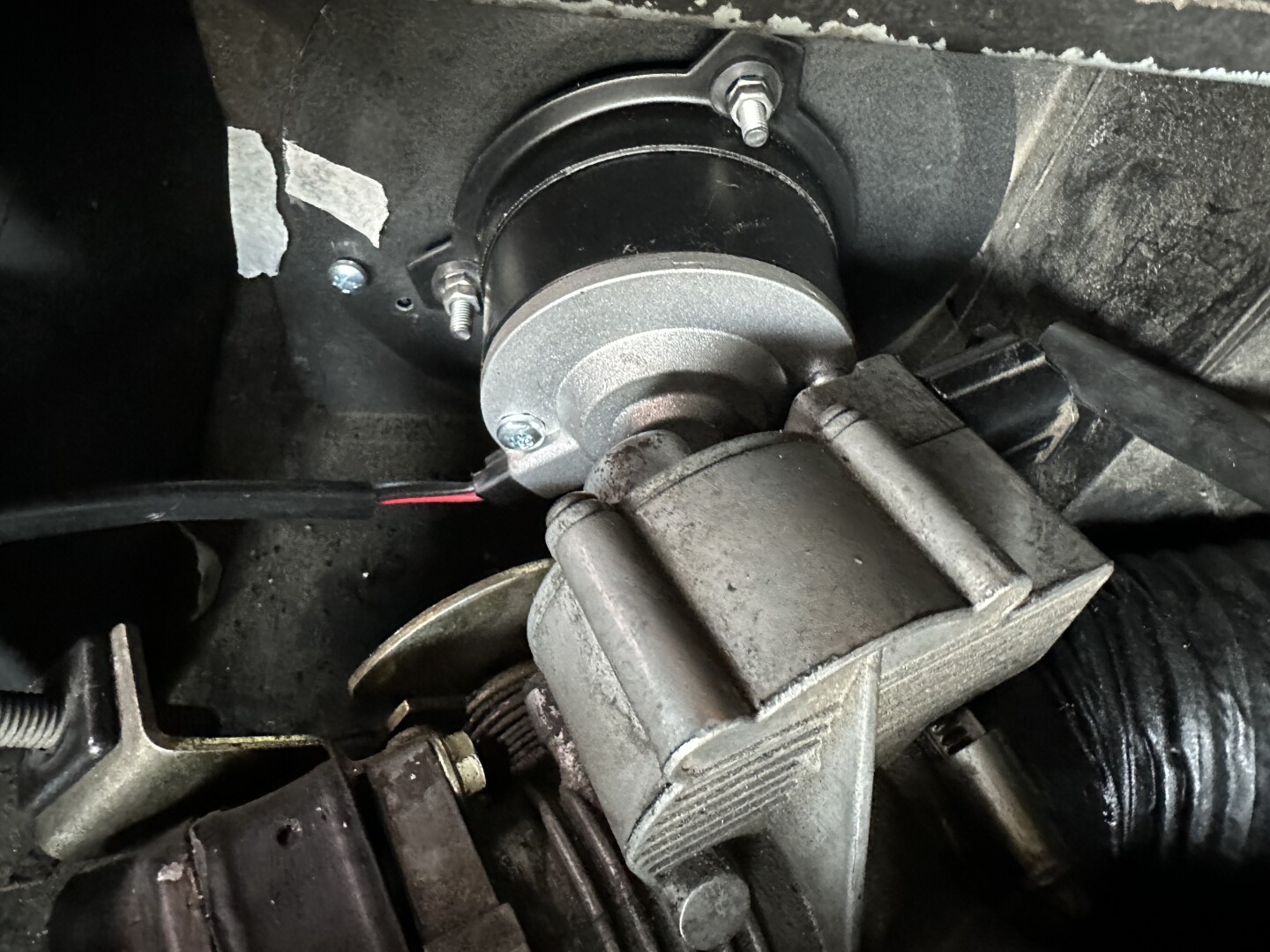

Hi All,
So to update you I bit the bullet and thought I would try the MGB heater motto below £85 as a replacement for the £380 +VAT KL one from Morgan
https://www.mgocspares.co.uk/produc...large-impellor-kit?nodePath=1/3/4/18/650
This fitted well provided I used 10mm spacers and sealant.
So a good option for others if the KL isn’t available or out of budget
Will update with some better pictures
Many thanks
Will
