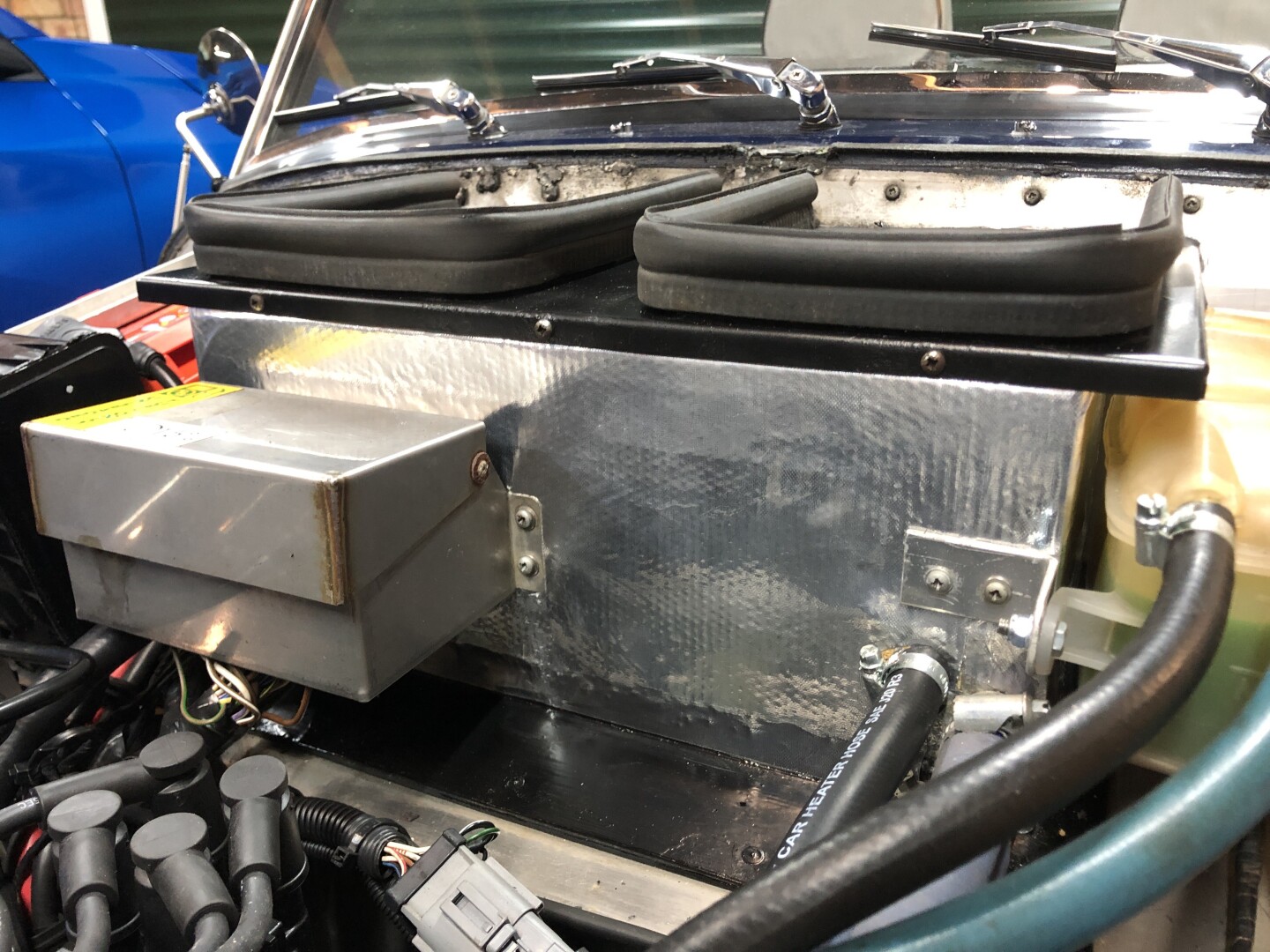

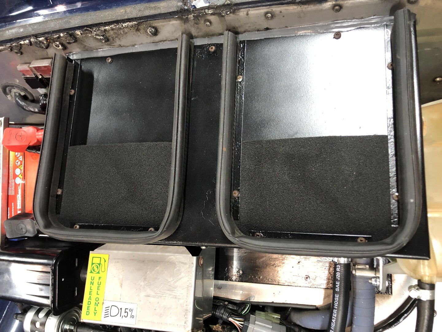

Further to my previous post, here is how it looks now. It was wrapped with Reflect-A-Cool self adhesive foil. I made a template for fitting and if anyone wants any material please PM me. I also fitted hoses to the drain spigots which now go to the ground and not the engine bay! Hammerite, new sponge and sealant completed the job.
