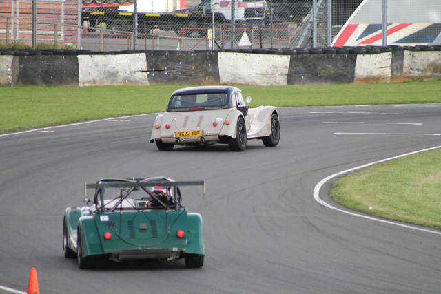

Matt Mole and his team were there developing two weaponised CX platform Plus Sixs, one race car with over 400 bhp per tonn and one a road car in a kind of Club Sport/Supersport spec, I passengered the road car for one session and would describe the power and torque produced by the tuned turbocharged BMW six cylinder engine as 'Monumental'!

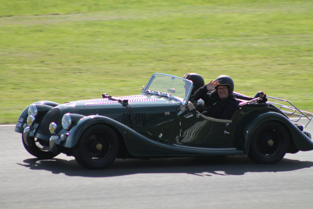

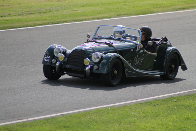

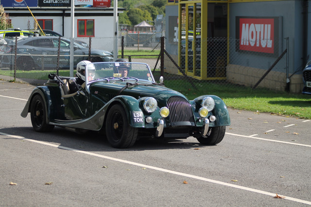

They all drove Monty and universally showered the car with praise, having little experience with other Trads myself its hard to guage how Monty compares, so I wanted the boys from the factory to give me their thoughts on the Mulfab front wishbone conversion, my tuning work and Monty's new Mintex MRM1802 compound track day pads that have proved so effective on the road.
Being long term Morgan employees Matt, Nathan & Iggy have driven hundreds of Trads and have litrally thousands of hours driving and developing these cars, so it was extremely pleasing to recieve the following comments...
"The car turns in so well and handles much better than a standard Trad"
"The brakes are outstanding"
"The engine and tuning are spot on; really good power, torque and drivability from a Duratec and it revs out cleanly too"
And finally from Nathan with Iggy agreeing ....
"I honestly think this is the best Trad I've ever driven "
Praise indeed from such an experienced team of Morgan Motor Company development engineers who clearly know the Trad species inside out thumbs
Monty now has the Morgan factory seal of approval woohoo
