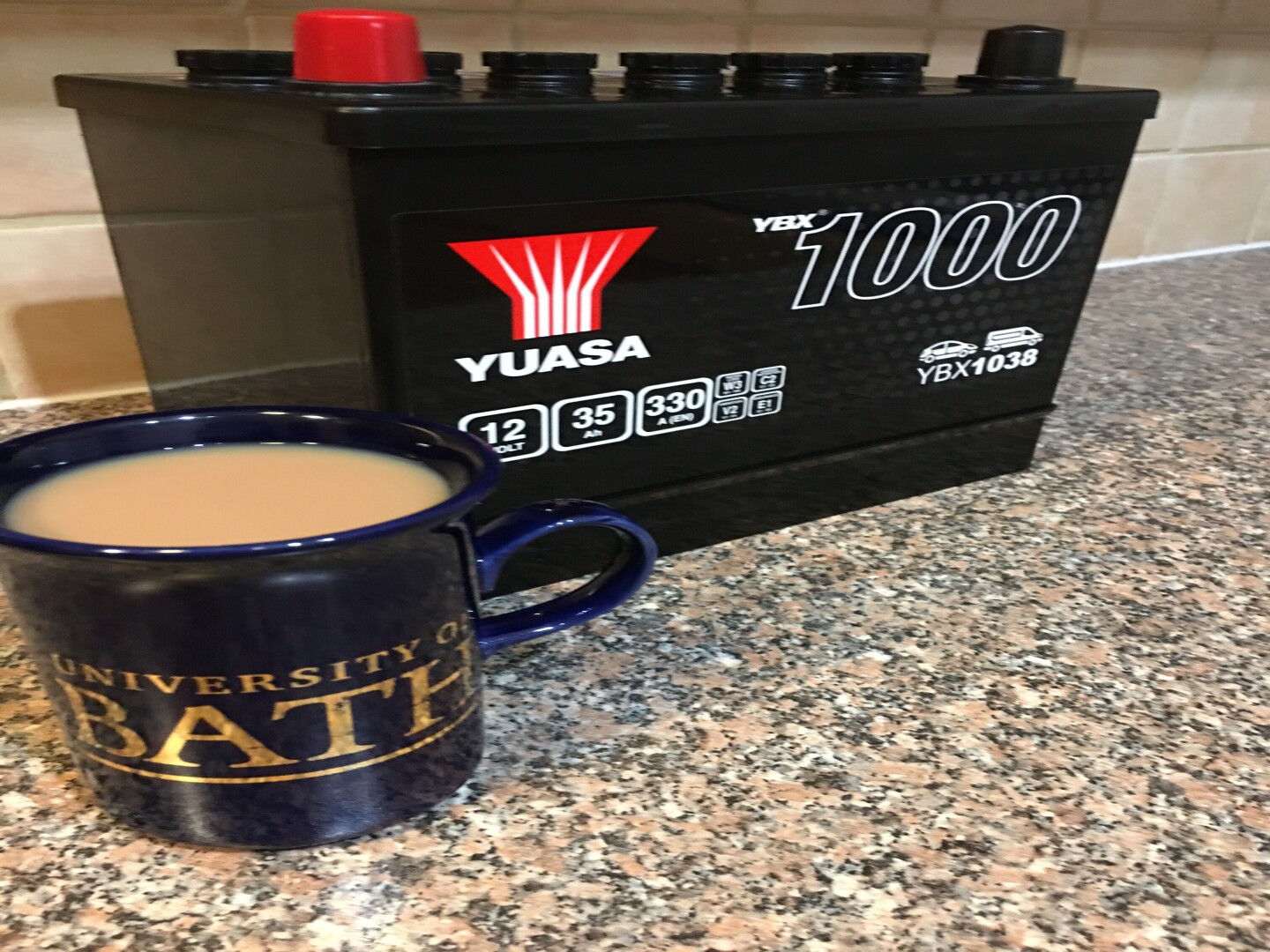

by +8Rich
This is the one I recently fitted to my 1999 Plus 8 - the last identical one managed 11 years without a charge so it did well. The car is used at least once a week year round which helps longevity as batteries need cycling properly it's what they thrive on, not continual float charging. £69 delivered.
