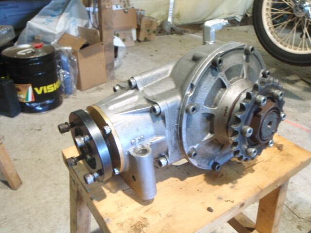

I am flabbergasted about the result of our reconditioned bevel-box .
The extensive driving tests showed us that we have no noise any-more.
The 'recon' has a lot lower temperature, driving cruising speed not climbing mountains : 65 oC to 75 oC.
That temperature difference explains also a lot.
We Installed a kind of air duct, which reduced the temperature most of time with > 30 oC., of course depending of the tarmac temperature.
I also tested thicker and more oil. ‘Amsoil 250 severe gear’.
Cooling is far better and the bearings are always at least half in oil.
Too much oil will not ruin the oil seals.
I experimented - for more than a year and over 12.000km - till 800 ml and never got any foam. I can easily see the building up of foam because I installed a separate filling tank.

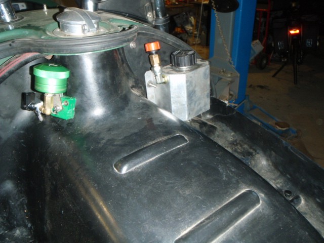

- A black aluminum filling tank with hose, support and fittings of 1 liter to make filling of the 750ml more easy and also to be used as a better air vent.
We can deliver : Extra costs around € 250

example of a reconditioned Bevel Box

fittings to external filling tank and side stop in steel

Air-scoop
Perfect alignment of the Bevel-box with the rear wheel, changing the bearings, using more oil ( 800cc instead of 300cc ) and the air scoop, is far more simple to do with the same cooling results.
I made just a simple scoop, and from several other owners I understood they had created something with the same idea.
But . . a scoop has only use when you get rid of the standard NVH kit.
You can see the air-scoop just in front of PB’s Bevel box mount. I suppose I have to change them maybe every 2 years because of the dents of ground contact. I can lift the car with my suspension, but still . . .
I make them very cheap of standard rectangular Aluminum U-Profile.
For me I got the temperature around 30 degr. C lower with that simple scoop.
5. Also on the recommended header tank for BB oil: is the idea that the BB is full of oil and the header tank is for expansion? Would be good to see where you suggest this is fitted - I would assume mounted against the back bulkhead under the luggage panel?
- The extra lub-oil tank
The main reason is a more ‘simple’ filling system for the Bevel-box lubrication oil. ( It takes some time with the tank and the long Hydraulic ( metal sheeted ) hose with the thick 250 oil I use )
I also could check with the tank during my test periods if the oil was foaming. With foaming the foam will easily build up in this tank and else not.
Foaming tells me there is too much oil, or too hot. But when occurs the lubrication is not working properly anymore.
That’s a point you should consider when putting more oil in the Bevel-box.
Yes, it is at starboard under the luggage panel ( Boot inner tray ) against the back bulkhead panel.
I attached it on black fiber board so you can easily take it away and I used a solar-panel ‘roof cable-inlet’ to cover the hole I made in the ‘Boot inner tray’ to get the oil-line through.
