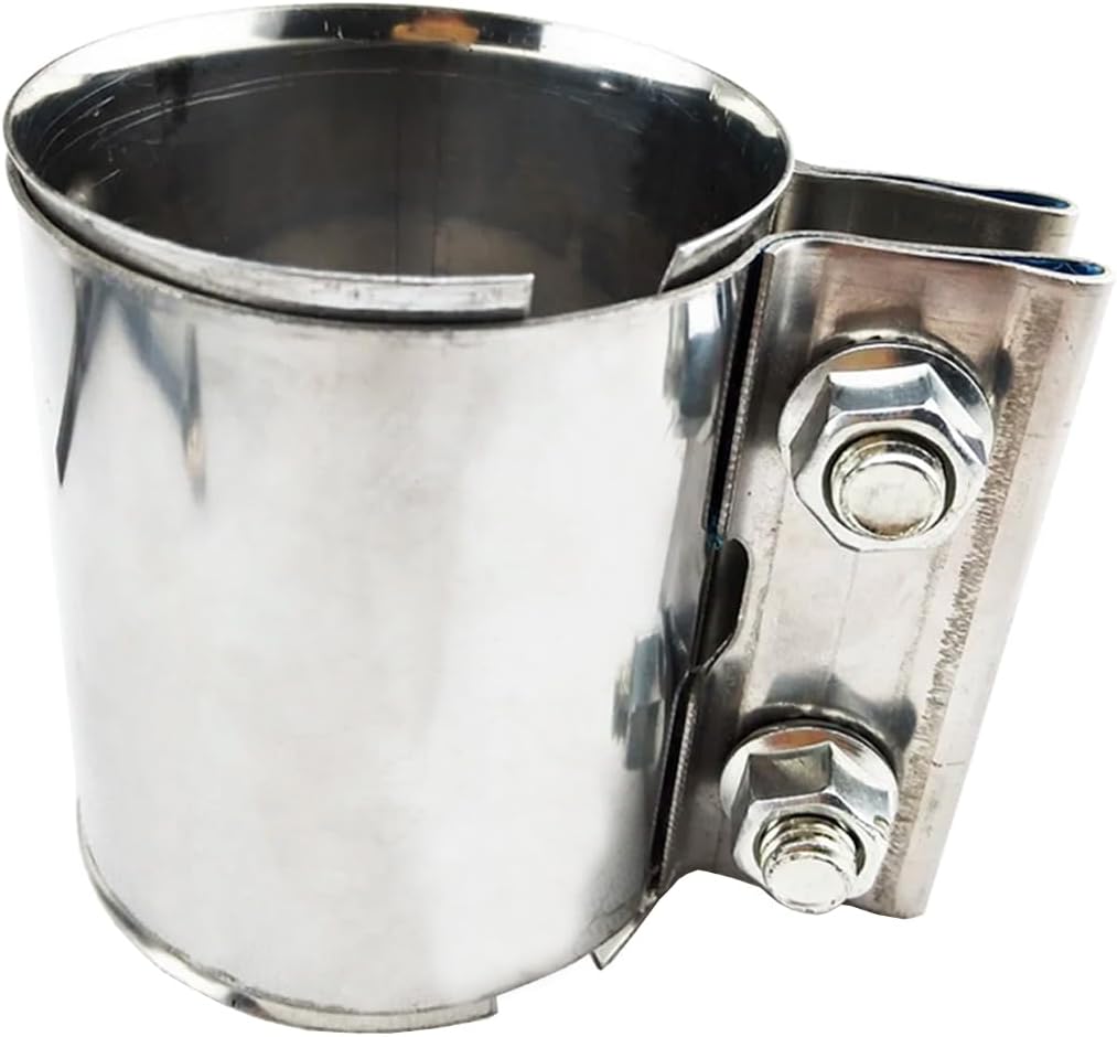

First I bought on amazon the
MOCNT Pipe Connector Exhaust Collar 65mm Band Exhaust Pipe Stainless Steel Clamp Double Exhaust Sleeve Fitting Length 87mm
€ 29,49
And fitted it on the Starboard exhaust pipe.
I got far better results.
Then I installed a second on the other Port pipe and since then I have no problems with irregular Air-Fuel ratios and got rid of the differences you mentioned.
I am not sure if this is the solution, but I can tell it makes your exhaust pipe fully closed.
Give it a try and when it not works for you, for sure your exhaust pipe looks more nicer than with that ugly hose-clamp.

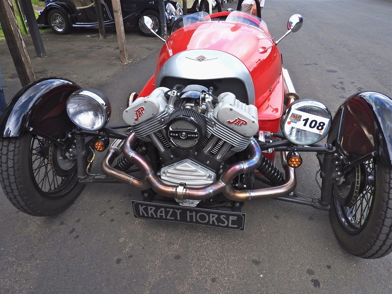

The early 90° V twin Moto Guzzi's (750 cc and up) had a balance pipe between the horizontal sections after the downpipes and before silencers. The 850 Le Mans also had this, but sported another balance pipe welded between the two downpipes such that they formed a single assembly. I always understood the mutual exhaust pulses improved scavenging between cylinders.
I remember Krazy Horse developing similar for their Stage 3 converted M3W as below.

Many thanks Herrie for the information about the 65mm x 87mm exhaust connector collar. I thought they looked a neater solution to the joint than the current screw clamp and worth a go. Now fitted, after replacing the cracked flexi joints in the headers. I have not had a chance to put a few miles on them but they seem to be a much better solution to the joint than the screw clamp. I have seen similar collars but not as good finish as the ones you detailed. The engine still "fluffs" at idle on the RH pipe, so no change there.
