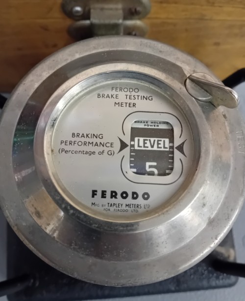

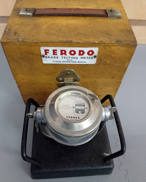

For those who are interested or may only have experienced modern MOT testing - this is a Tapley meter
I'm quite proud of mine as it still has the storage box
This is how they are set level, usually in the passenger footwell - the base is heavy cast iron

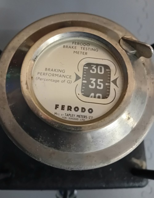

This is how they read - deceleration in %age of G, the higher the number the harder you hit the windscreen grin2
