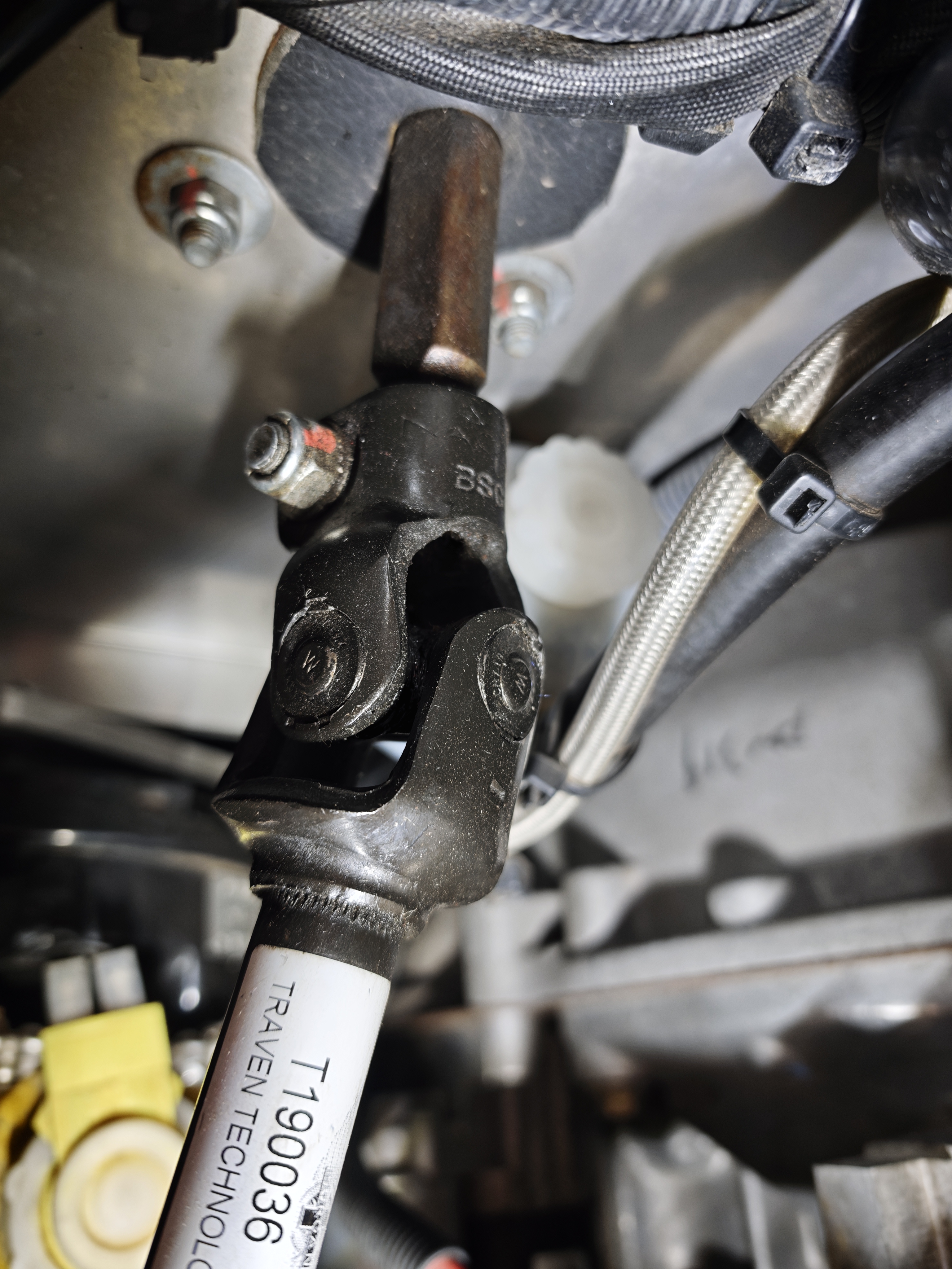

FWIW this is pic of my upper steering UJ as seen with steering wheel in straight ahead position.
As can be seen the spline bolt appears to be a right angles to the flats on steering wheel shaft. As best as I can judge the lower UJ connecting directly to steering rack appears to have matching spline bolt around 30° further clockwise as viewed from front of car.
