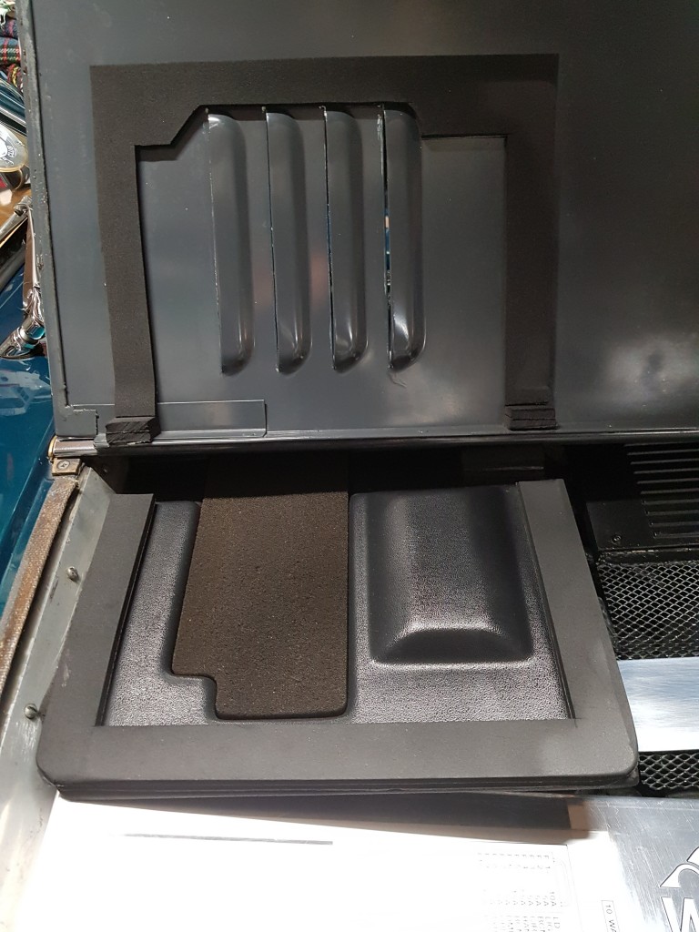

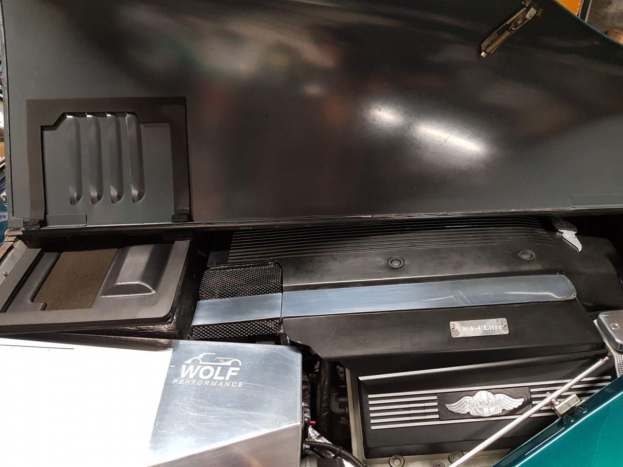

- like many others, the foam seal on my Aero had become a little 'crumbly' with age/heat.
I cut a new seal from some neoprene foam rubber, built up in layers.
[img]http://[/img][Linked Image]
In addition, I also replicated the seal on the underside of the bonnet so that the two mate together when closed.
There is a gap in the middle of the bonnet which also needs a little neoprene seal (see the square, end patches on the bonnet seal).
It is all a bit 'trial and error' but certainly seems to have improved things ( a little !) .....

Looking at James photos I've realised, for the first time, that the louvres on the Plus 8 are external, in that they are the mirror image of the ones on James S1, so they actively grab air from the outside, bouncing off the windscreen, this photo makes it clear.[Linked Image]
James
James, that's a neat bit of neoprene engineering thumbs

- thanks Jon; I was hoping for a 'Blue Peter' style 'neoprene user' badge from Dave....... innocent
