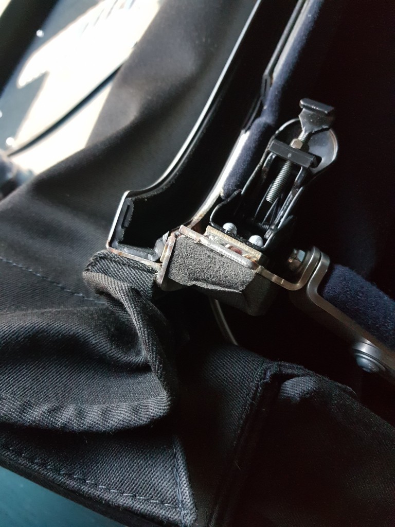

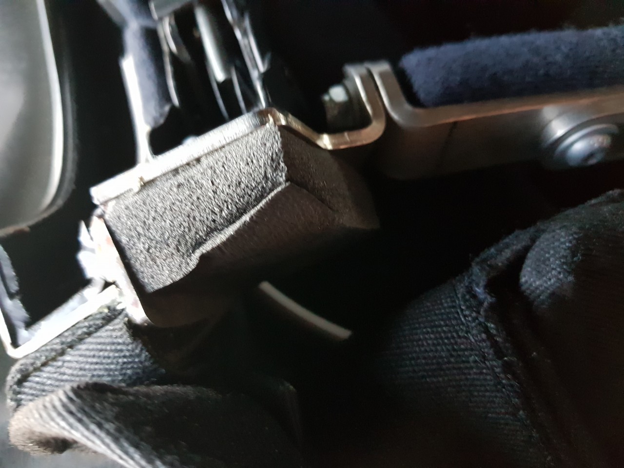

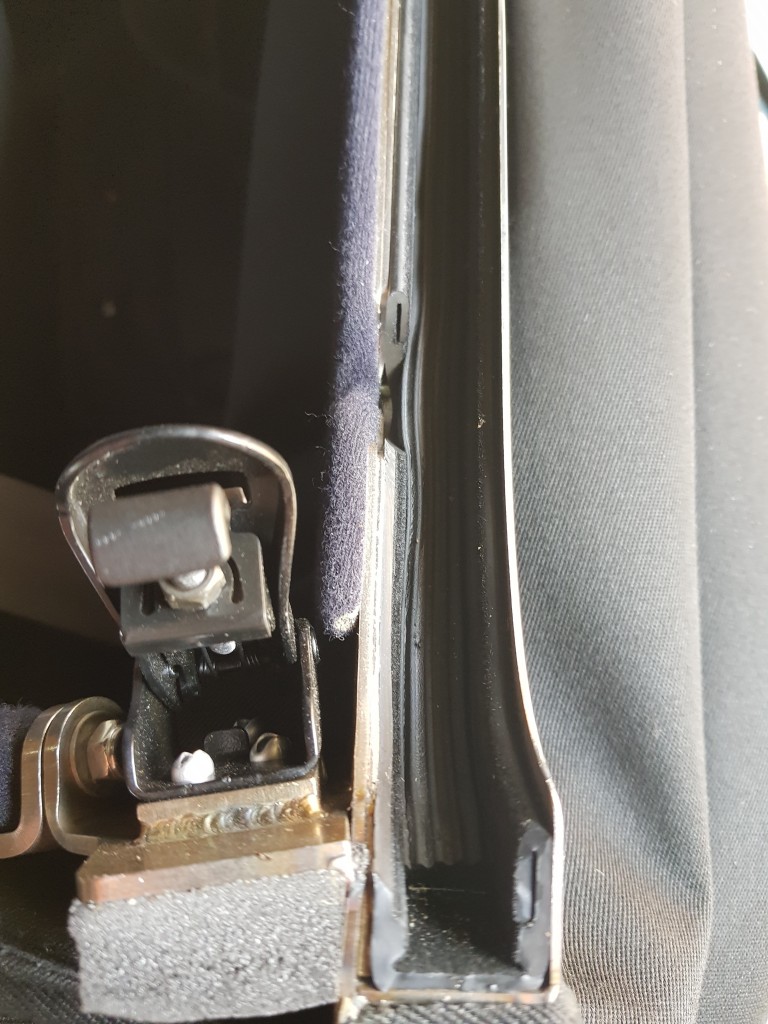

This is MMCs latest on the header rail from a Roadster demo I borrowed last week. Please note the header leaked & mine doesn't but that might have been the set up. The hooder rail wouldn't release at the back so the hood alignment & tightness to the top rail couldn't be adjusted easily.
They have fitted some foam to seal the gap by the A pillar. I will copy that as on mine it let in draughts.
They added this ribbed strip of rubber inside the seal but you can see it partly fouls the U shaped cut to allow for the sun visor mounting arms
