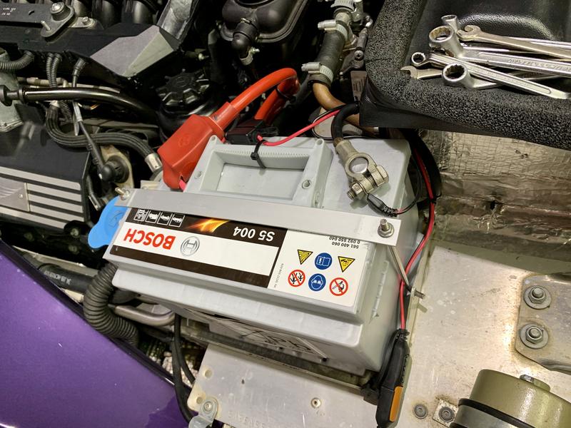

Much better way of connecting charger thumbs
My Ctek clone charger came with an optional extra charge lead. It allows permanent hook up to battery, terminating in non reversible high current plug to match chargers, just as yours appears to have.
