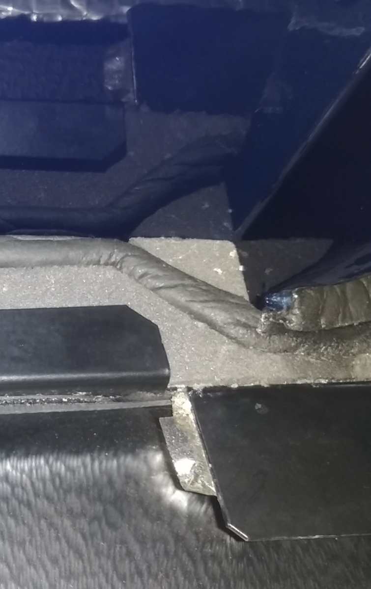

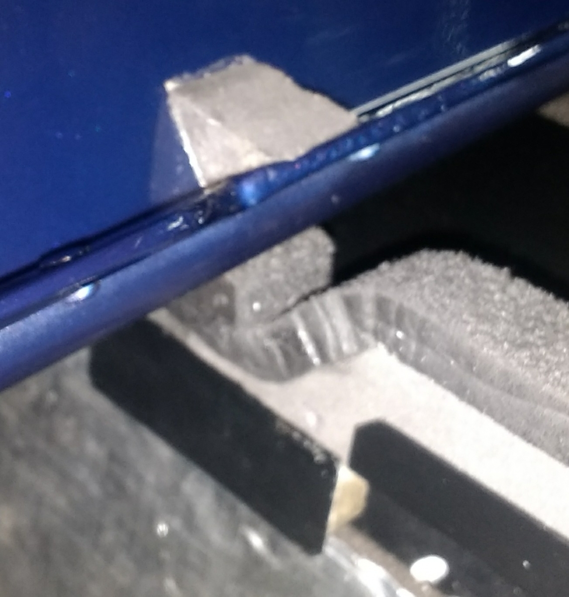

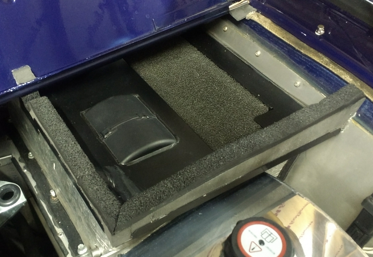

He suggested carrying out a simple modification to the heater box to prevent drawing hot engine air in, he also provided a link to some images of the modification he carried out. My heater box appears to be a little different so I thought I'd share some photos of how I carried out the upgrade.
I purchased some 20mm closed cell foam from e foam on the internet, this proved to be different from the original that was fitted by the factory in as much as it was closed cell throughout and a good bit more rigid. Seeing as I'd bought it and being a "canny Scot" I came up with the following solution.
Templates were made to fit exactly between the top of the heater box and underside of the bonnet, these were then reduced by 5mm in height, the original spongy foam was carefully removed and cut in a band saw to 10mm, the rigid foam was glued in place using spray adhesive ( purchased from the foam suppler) and the spongy Morgan foam glued on top.
The pictures show the completed job, a close up of one side showing the triangular piece fitted to the underside of the bonnet and one showing how it works at the hinge with the bonnet closed. There is a piece of the factory foam in the centre which gets gripped between the two flanges of the hinge creating an airtight seal. The masking tape on the underside of the bonnet was to prevent any glue seeping up and sticking to the paintwork when I closed the bonnet overnight, this to allow the adhesive to set properly.
I haven't had an opportunity to try it out yet as it's currently around 12° and raining here at the moment. But Gambalunga told me when his Aircon broke he had the fan on full speed blowing cool air and, with the hood up it was tolerable even in the Italian heat.
Whilst traveling towards the black forest region in Germany we were subjected to rain of biblical proportions, so heavy in fact the autobahn ground to a halt and we decided to pull into a rest stop till it passed. Whilst waiting I got this annoying drip on my lower leg. So whilst upgrading the foam I also fitted hose from the heater box outlets to drain the water over the top of the bulkhead and fitted seals around the box that covers the ECU. I'm sure this will be of major benefit with the Scottish weather.

Well done Gordon. I did something similar and covered the foam in duct tape to protect it. ![[Linked Image]](https://www.tm-img.com/images/2019/07/19/20190719_122437.jpg)

A quick update. I had the car out early this morning, hood up, engine up to full temperature I filled the car with warm air then switched to cold. Cabin cooled really quickly so looking like a success.
Downside could be, on the way home with the hood down and still a bit "nippy" the heater didn't pump out as hot air as it used to. Hey Ho, you can't have everything in life, this is what jackets, hats and scarves are for isn't it?

Gordon, neat little V notch to stop the bonnet lip tearing your new seal
