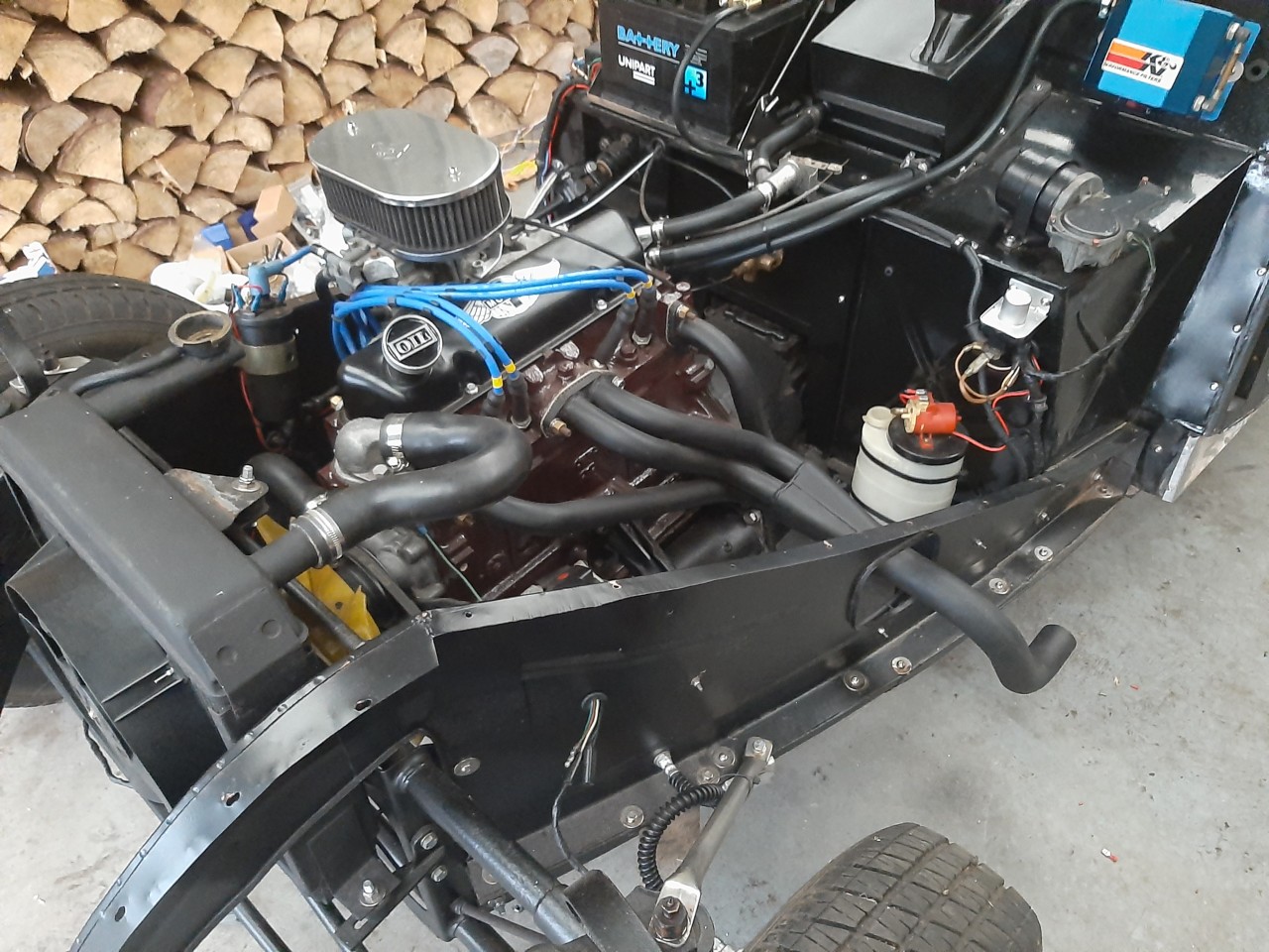

Not posted for a while ..... engine bay completed ..... dash in and bulk of the wiring done .... found a Davies-Craig electric rad fan that was once on my racer (but removed for weight saving reasons .... must have saved all of a Kg smile ) ..... will no doubt prove useful on hot days in traffic.. Body panels done and being prepped for paint .... that may hold me up a bit as the weather has turned and I don't have a heated booth (or any booth for that matter ) .... will have to pick a dry mild day and warm wherever I spray as well as I can .... could be a bit of a wait. Plenty to be getting on with tho

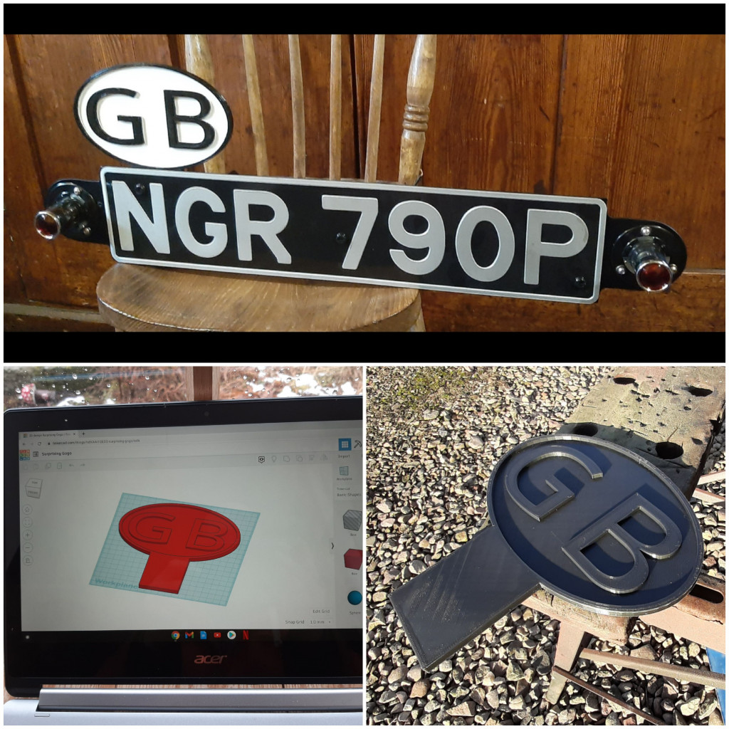

Another one was the rear number plate mounting ..... the mounting plate fixes to the angle iron spare wheel supports on the 4 seater ..... it carries two repro vintage Lucas MT 211 motorcycle rear lights (rear/stop/numberplate light in each ) ... they'll be slaved to the existing rear lights and add a bit more visibility to the rear end .... seeing as even a modern mini has a back end the size of a barn-door and lit up like a fairground that won't go amiss.
Also wanted a GB plate as one will be needed for foreign touring .... created a CAD file then printed out on the 3d printer .... bit of painting and all good .... seems remarkably robust but if it gets damaged I can always print another one.
